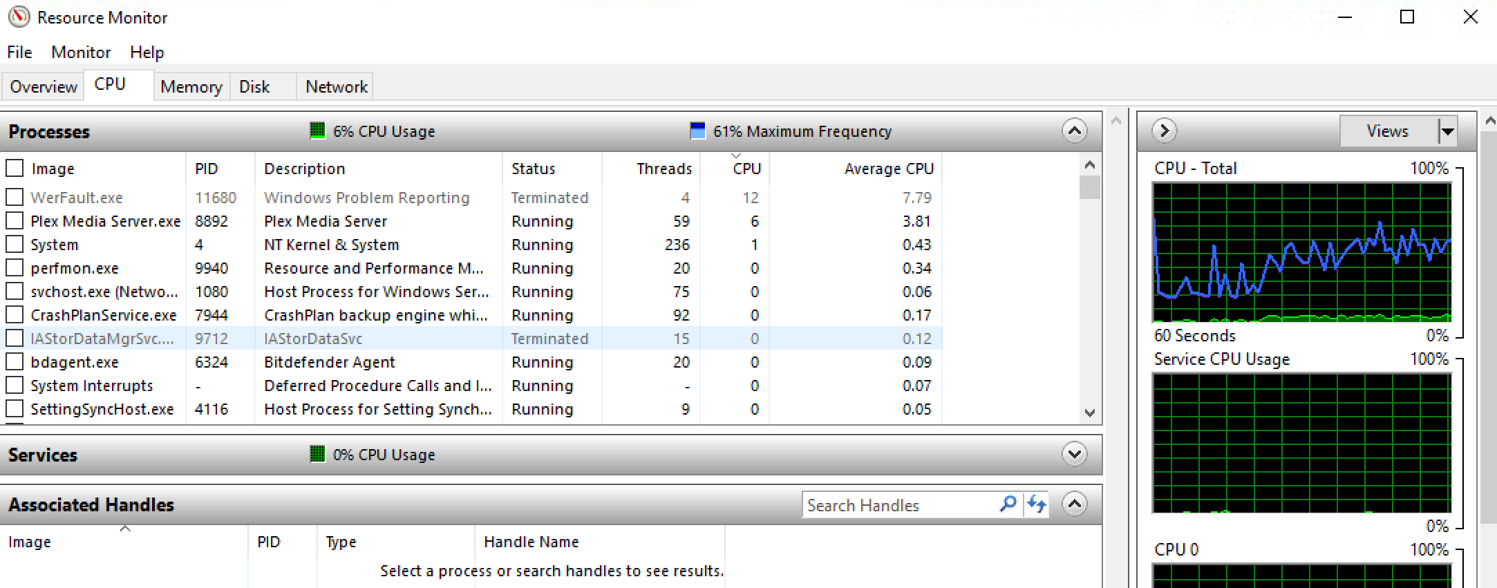

Indeed and its getting more Odd. In attempting to check the Transcode CPU usage, the whole thing crashed.. So, I cleaned up and tried to repeats. Here’s what I have (sorry this is long)
The XBOX ONE S Starts to direct play the file (confirmed in “Now Playing”) - NO Transcoding is happening, you can see my CPU usage (at 20 seconds in).
It gets about 30 second into the movie, but now, instead of switching to Transcoding, it crashes, you can see it tries to transcode (CPU) - But you can see the process is terminated.
I pulled the LOGS while it was direct playing and After the crash.. Now, I had to reboot the whole server to get Plex to run again. I tried just launching Plex, but it would immediately crash.
I was able to clean up and do it again, 30 seconds in it flips from Direct Play, to Transcode, and the PlexTranscoder.exe pop up after the freeze and starts working properly… no crash.
Log attached.
