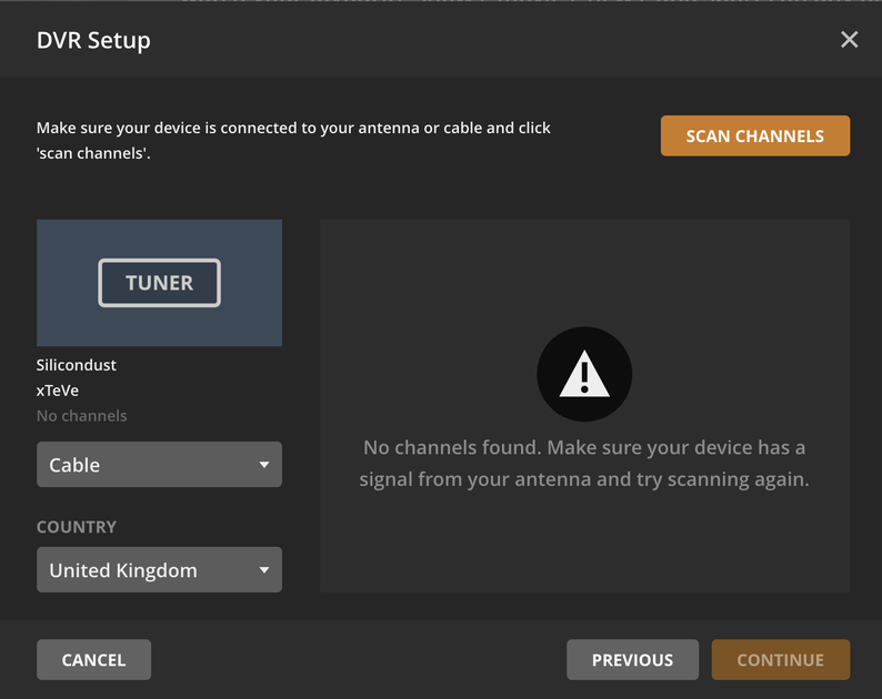

Hi…
Am i missing something here? I can’t add xteve DVR in plex anymore. I enter the url and port etc, it finds it…no probs.
But, I can’t steer it away from selecting Cable, and country…I used to be able to at some point add the xml url details etc…I can’t do that now.
I have an option to scan channels, but it will just moan at me and say’No channels found. Make sure your device has a signal from your antenna and try scanning again.’
If I add ā€˜Cable’ and ā€˜Country’…I can’t continue.
I’m stuck.
Am I doing something really stupid here?
thnx
Oh wow, I thought I was going crazy! I have the exact same problem. Sometimes I do have the tuner with channels and can click next and get stuck there. But mostly stuck at the exact same dialog as you.
No matter how many restarts, log clearing, temp dir cleaning.
What’s your PMS version? Mine is: 1.19.3.2843
I found I had to unplug my HDHomeRun and restart the PMS to get it to show up
ok…i’ve figured it out…and i was being dumb.
I had applied a filter, and it was knocking all my channels out…so xteve had no channels to make available.
I removed all filters. refreshed playlist and xmltv…then re-added back in plex again and it found it.
what a numpty…
