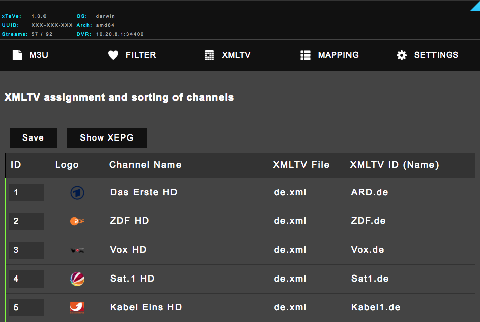

Features:
  • Merge M3U files
  • Merge XMLTV files
  • Channel mapping
  • Automatic M3U and XMLTV update
  • Filtering M3U lists
  • Number of tuners adjustable
  • Compatible with Plex EPG and Plex Guid Number
  • Supports XMLTV with gzip compression
  • HLS / M3U8 support

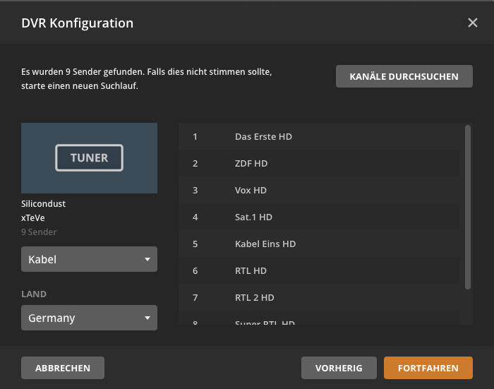

Do I understand this correctly, that xTeVe downloads/updates the IPTV playlist and “emulates” a tuner to supply these channels to Plex?
Sounds pretty useful to me :slight_smile:
Yes, m3u playlist and xmltv EPG

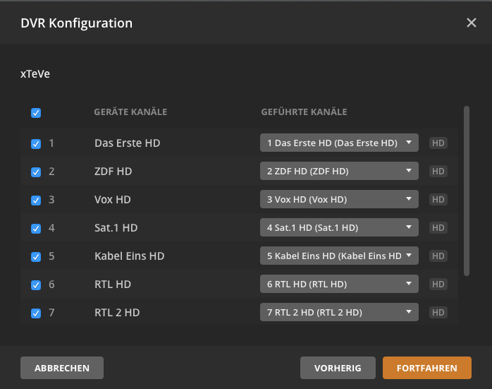

I have a hdhomerun connected to an antenna configured in my PMS. With other apps like yours that I have tried, Plex forces me to only map to channels in the handfull that I get OTA which is obviously a problem. With your program setup to use XMLTV, would I see in my guide my OTA channels from my hdhomerun and the IPTV channels?
If the tvg-id in the M3U has the same value as in the XMLTV, that should work.

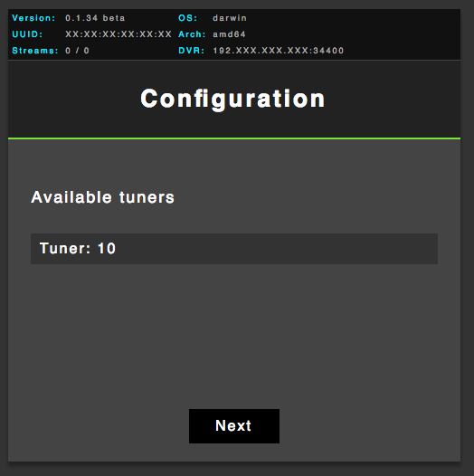

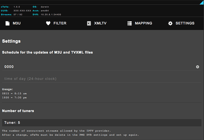

Hello, I apologise if this was included in your documentation but I could not find it. Is there a way to allow xteve to use concurrent streams? So essentially making Plex see multiple tuners instead of just 1?
This feature is not yet available, but will come later. Please be patient.
I am currently working on a user interface for configuring xTeVe.
Awesome, sounds good to me. So far I’m very impressed with how well this working.
