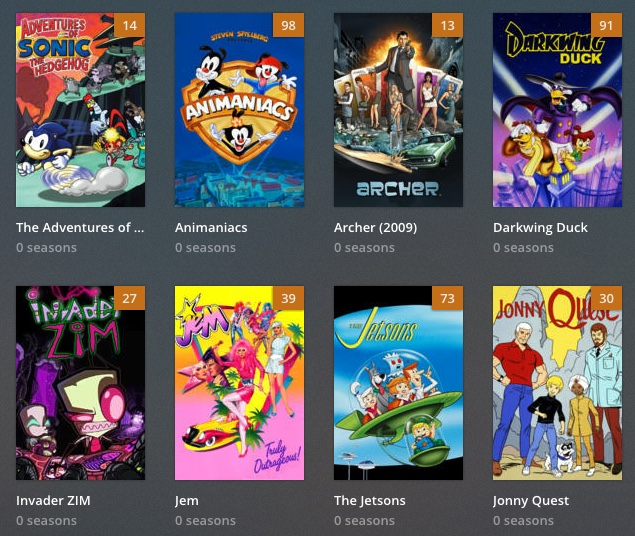

0 Seasons listed on bottom - first time noticing this
Hey I don’t know if this is just happening on my install but I’m getting “0 Seasons” listed under every tv show, even though I have more than one season for each show listed. I have a separate server for my mom setup and we both are running the same Plex Server Beta’s and her tv shows have the correct number of tv seasons properly showing. My server on the other hand is showing 0 Seasons for every TV library. This a bug? *I mean, it HAS to be a bug cuz I wouldn’t have noticed otherwise lol - I never had issues until this latest beta.

This is what I found. After I saved the logs, I followed the database repair procedure and now the Server app won’t open. I have had to repair my database before but on a previous install on this same machine so I know I followed correctly. What I don’t know is how to go about fixing the repair process to fix what’s wrong in my server database. The original com.plexapp.plugins.library.db file was 1.73GB but the newly repaired com.plexapp.plugins.library.db file says 33kb. I haven’t tried using another backed up database so I’ll report back in a few.
