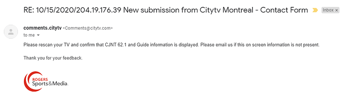

Update: I contact them and they modify the PSIP
Thanks for your help!
