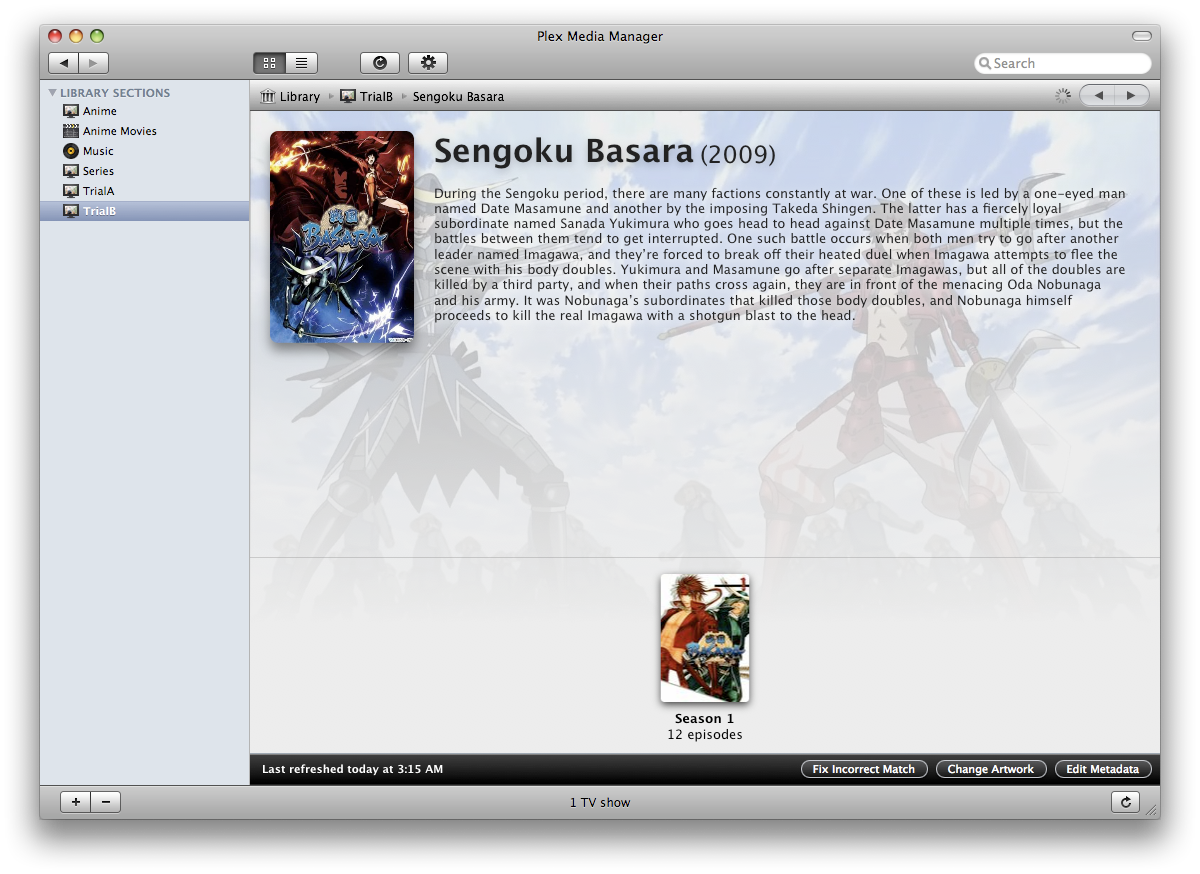

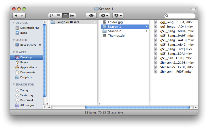

The folders I am adding to the media manager have the following hierarchy (each season has 12 episodes):
http://img.photobucket.com/albums/v210/Rayes85/Picture3.png
If I add the parent file of the show to the media manager with the default scanner, I get this:
http://img.photobucket.com/albums/v210/Rayes85/Default_Scanner.png

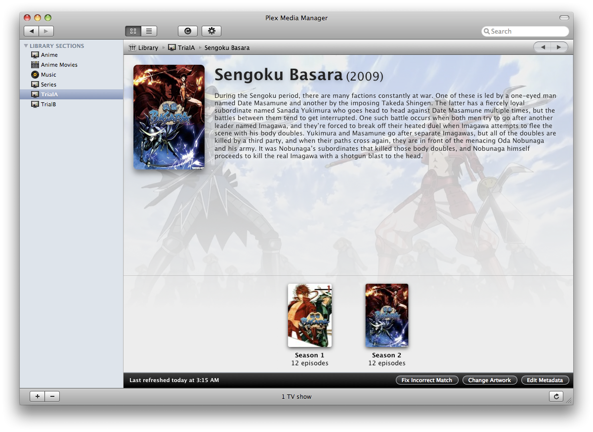

If I add the parent file of the show using the Tweaked scanner, on the other hand, I get this:
http://img.photobucket.com/albums/v210/Rayes85/Tweaked_Scanner.png
Both seasons are included in plex, but overlap (where you are given a choice of which episode 1 to play when you navigate to this section in the actual media player)
This occurs irrespective of which agent used (including no agent/personal).

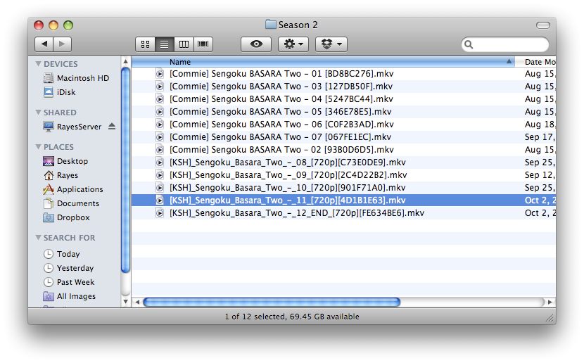

As far as the weird hex issue is concerned, consider the highlighted file in the following link:
http://img.photobucket.com/albums/v210/Rayes85/Naming_Example.png
Under the default scanner, this file would show up as episode 11. But under the tweaked scanner, this file would show up as episode 63. The only way I can see this episode being represented as 63 is because the last 2 values in the hex number in between brackets at the end are 63. The same holds true for the 12th episode, which comes up as 634 under the tweaked scanner (comes out properly as 12 in the default scanner), where 634 is found in the bracketed hex number as well (though in the middle). Oddly enough, none of the other files are influenced by their own respective hex numbers(they show up as their proper episode number). Why these 2 episodes in particular are thrown off, I don’t know :frowning:
Note that the reason why you are seeing 12 episodes in the tweaked_scanner screenshot above, and not 14 (due to episodes 11 and 12 being seen as 2 extra episodes 63 and 634) is because I renamed all the files so that they don’t have any hex numbers for testing purposes (not having a hex number would result in the 2 aforementioned episodes being seen as they were intended to in the series chronology). I can’t quite get why this happens for certain hex numbers and not for others (the majority), and why it doesn’t happen at all with the default scanner.

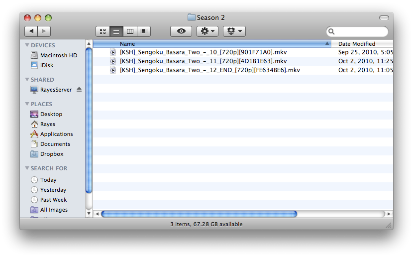

Edit: Will add some extra screenies to show the hex number issue:

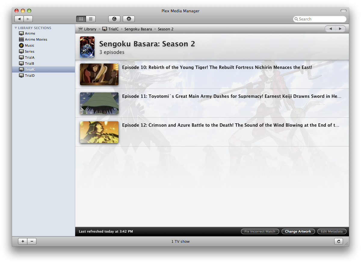

I took the last 3 episodes from season 2 (10-12) and placed them in a new folder to show the effect.
http://img.photobucket.com/albums/v210/Rayes85/NewFolder.png
When I load them with the default scanner, they load up perfectly as season 2 with proper episode numbers(meta-data does load, but not fully since tvdb does not have episode synopsis for this season - episode titles are correct however).
http://img.photobucket.com/albums/v210/Rayes85/3Files_DefaultScanner.png

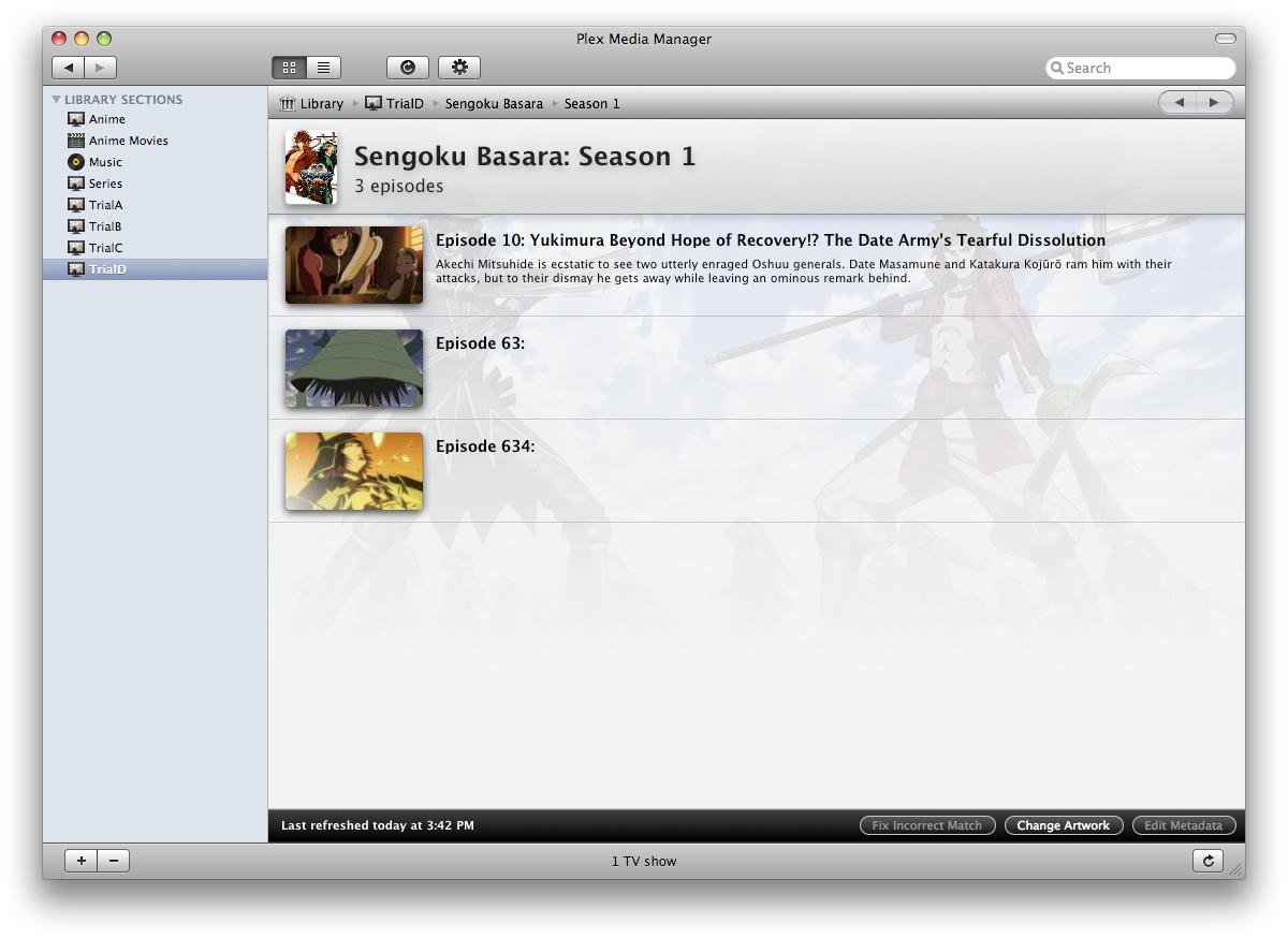

When I load them with the tweaked scanner, I get this:
http://img.photobucket.com/albums/v210/Rayes85/3Files_TweakedScanner.png
Notice episode 10 remains the same, but 11 and 12 are changed to 63 and 634 respectively. Why episode 10 is spared from being changed to episode 901 for instance (901 is in the bracketed hex number), I don’t know. Also notice that the season is loaded as season 1 (I’d assume by design of the scanner), and the meta-data for season 1’s episode 10 is loaded (as opposed to the proper data from the default scanner trial).
So I finally got some time to sit down and look at this. It seems I had commented out the line
(file, year) = VideoFiles.CleanName(file)
which I’m hoping will clear up the hash getting interpreted as an episode number. (Otherwise, I honestly have no clue how the default scanner is doing it.)
I also made a tiny change to the regex for getting the season number from a folder, which seems to fix your problem with non-absolute-ordered stuff that doesn’t have the season number in the filename.
It works for the fake files I set up in the form “Sengoku Basara/Season 2/Sengoku Basara - 05 - Gibberish Gibberish.avi” Let me know how it works with your actual files.

Works perfectly now :slight_smile: Both issues fixed
