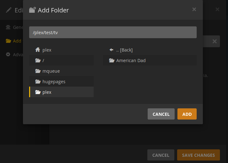

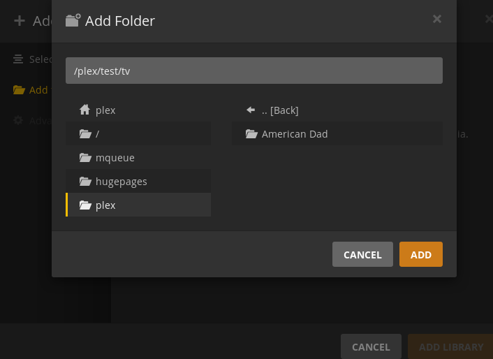

I would like you , as a demonstration & test case, to create a test area.
Next, cancel all scanning and add the TestTV section - referencing only this directory.

Ok. So right now my working directory is /plex/Media/{Movies,TV Shows}/files This works fine for the movies just not the tv shows. Do you know why one would work and the other wouldn’t?
These are the current test and production trees:

Looks like it still isn’t seeing the files. Attaching logs..
Plex Media Server Logs_2019-07-02_20-01-10.zip (2.2 MB)
I’m not sure how to explain this…
I repeated the steps above 5 times with no success. On attempt 6 I am seeing a test file I put in there.
So, I guess it is working now.
