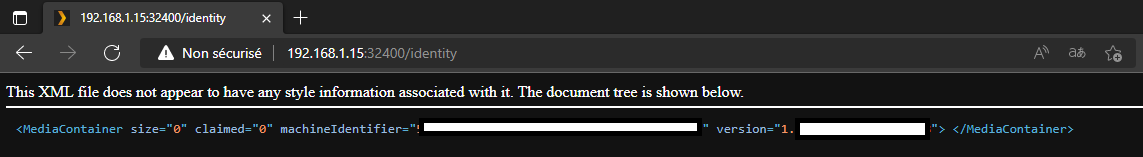

But there is another problem, i already tryied to find it on my plex page : i dont have my unclaimed server on Plex > General (see the picture below)
You’re checking the Plex Web > General settings – not those of the server.
Are you accessing those settings via your server’s local IP from the same subnet? → http://192.168.1.15:32400/web

I explain :
your message made me think about the protocole “http” as ‘JaysPlex7’ told me to, and you told me that i was not on my server itself, to see the good menu.
Now it works.
For the guys who have the same problem as mine, here is the solution :
  1. Make sure that your router has the exception line for the port you are using for Plex. For example : 32400 → TCP/UDP
  2. Use your local address (connecting your server/nas), for example : 192.168.1.10:32400
  3. Use the HTTP protocole and not HTTPS (or you will have an error), for example : http://192.168.1.10:32400/web
After that, maybe you will have to configure your server again (set folders, etc) and sometimes the page will infinite load, just open the page in another tab and then continue to configure your server.
Special thanks to tom80H and JaysPlex7.
Thank you to the Plex community :heartpulse:

That will not work when trying to claim a Synology based server.
Use a incognito/private browser window. Go to http://<syno_ip_address>:32400/web.
You have to use the IP address when claiming. Using a hostname, Synology quickconnect, etc will not work.
That was the piece I was missing, thanks! Didn’t see that tidbit of information anywhere.
It actually also works if you use the mdns .local hostname; my Synology is named blob and I was able to adopt it at http://blob.local:32400/web.
