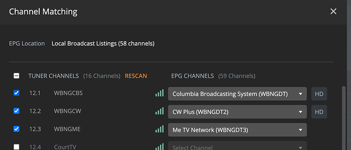

I’m on Bunny Ears. The local OTA broadcast listings have missing channels. I have the option to add additional provider(s) listings to pick channels from and match my scanned channels into my guide.
There are some channels another City market has that mine doesn’t. For instance i have Los Angeles OTA and Charter that actually has my missing channels i can match from. Portland, OR wasn’t favored too much in that regard. Lots of inaccuracies
You do have the ability to adjust your channel matching

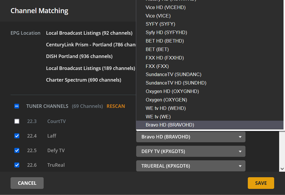

ok so this is where I’m stuck.
How do I add another EPG location?

Ok so I got it to work -
I used a Hauppauge 955Q - and had it hooked up to my wall which gets 1 Spectrum station telling to me subscribe (and a bunch of premium random stations from PPV i guess - they disappear after the movie is over - not sure/why that works)
Anyways, I was able to add Spectrum line up to my OTA HDHomerun Lineup, and just replaced one of the unused channels with Bravo listings. Disconnected and removed the 955Q from Plex and my computer, and it works how I want. I can now see the listings!
