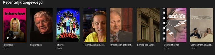

Hello,
I added “Breakfast at Tiffany’s (1961)” with extras in subfolders, but now the extras are shown as moves?
I have all my extras added in subdirectories all is fine only on new added movies with extras PLEX does that.
any fix for that?

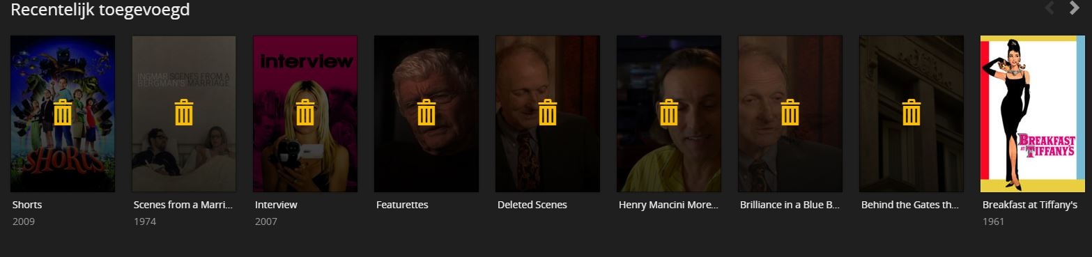

I removed the files and added them again, but still the same problem, now without trashbin?
does anyone know why this happens?

EDIT: same as OP, removing, re-adding, Plex dancing, etc, would result in trashcans sometimes and sometimes not, but always the extra as a movie.
Can you provide the exact folder and file names for these extras? From the screenshot I can only guess but I don’t think you have it named correctly. Looks like some extras are getting matched as actual movies. Local extras don’t work if there is more than 1 movie in a folder.

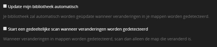

I switched of the scan and partial scan on changes detected.
now it looks like it works.
:frowning: not happy to switch of futures.
run scan on movies right now lets hope it will not add the extras as movies again

your right it looks like there is a bug, if I turn on partial scan if changes are detected then extras gets added as movies, if I have switched it of and add movies and extras and run refresh all on the bibliotheca all is fine no extras added as movies.
I hope the developers look into that issue and can fix it soon.

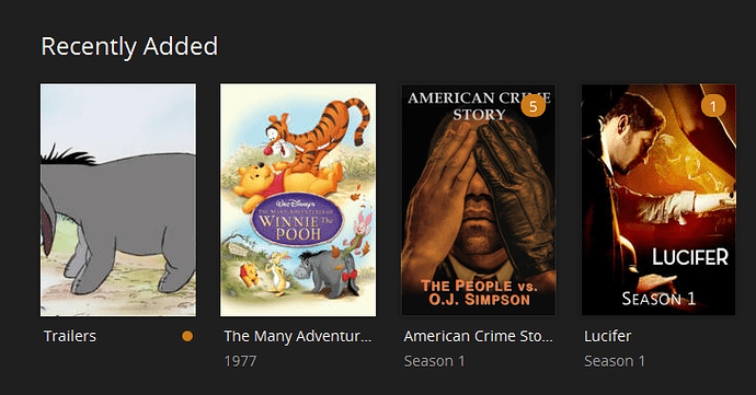

I copied a movie over from the Grandkids’ library to the Movies library, after I re-enabled partial scan
The Winnie the Pooh movie popped up onto “Recently Added” and was identified correctly. About a minute later, a new movie called “Trailers” showed up on recently added.

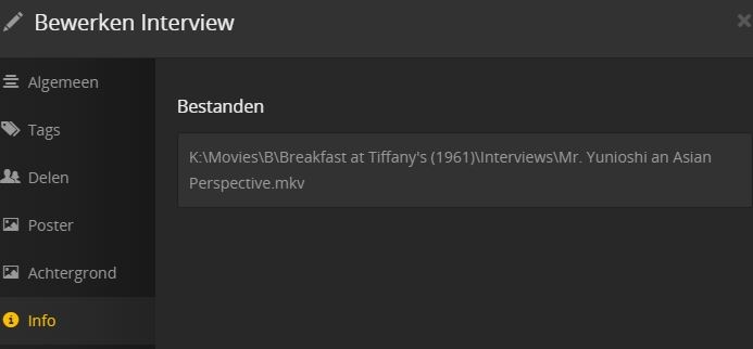

the “Info” for the new movies shows these paths:
Initially, the Winnie the Pooh movie did not show a trailer. A refresh brought the trailer in. That’s probably consistent with before, because I tried a lot of things to get rid of the fake movie. I’ve included both XML files, before and after the refresh. Refreshing the fake movie trailer didn’t seem to do anything. There’s never been consistent behaviour on the trailer after a refresh - sometimes it would make it unavailable, or show a trash icon, or do nothing like this time.
