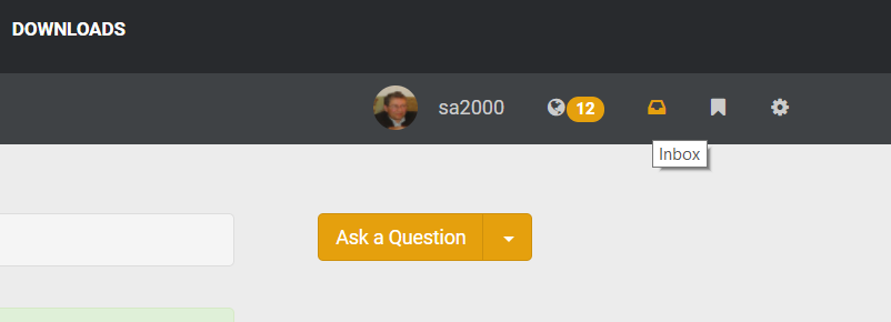

I’m not sure how to send you a private message. If you can fill me in on that, I have the ZIPped file ready.
I checked the router settings and logs. There are no firewall settings which should impact Plex. Having said that, I know firewalls can be tricky.
I think I know why Plex could not communicate as rapidly as desired. Router logs show a number of denial of service attempts, which would slow service. I will contact my provider on this.
But that doesn’t explain why Plex did work - and work well - prior to the update. It’s the same firewall as before
Click on the Inbox icon at top right of the screen and then select New message
