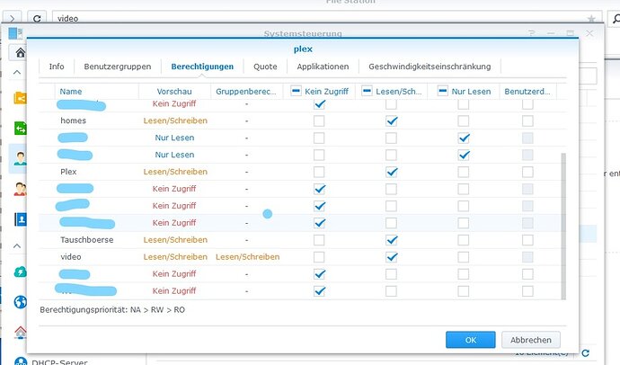

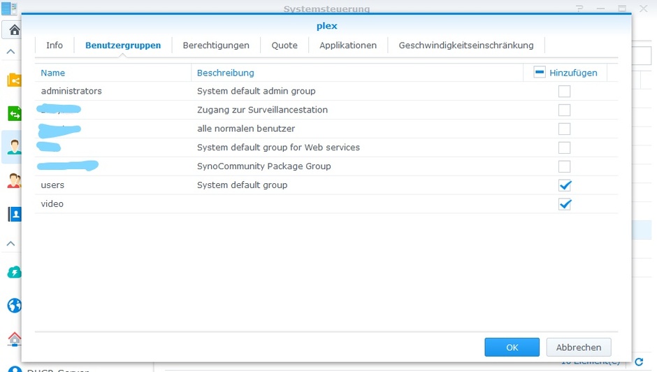

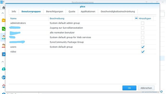

these are the groups the plex user is in:

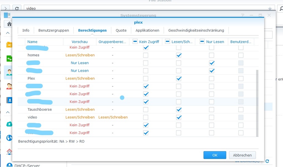

these are the permissions the plex user has. My media is in a subfolder of the /video share:

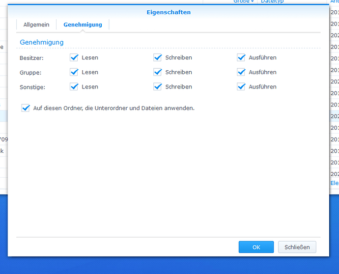

this are owner and group of the /video/films directory, where the media is stored:
These are the custom permissions of the same folder and subfolders:
