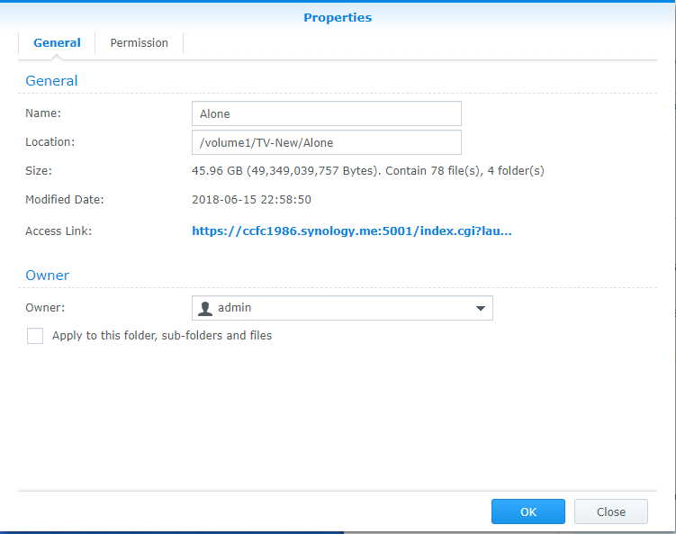

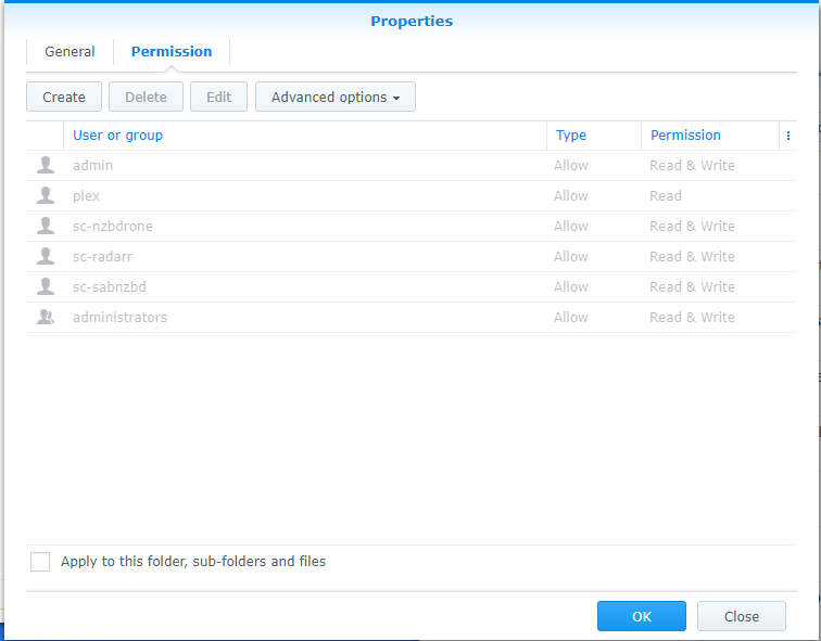

I ran this command to reset the permissions on the Alone folder after i copied it across - this set up the parent ACL stuff to the Alone folder and its sub-folders (at least i think it did - seemed to have!)
I have attached some screenshots/links for the current config of the new share and its folders.
d---------+ 4 root root 4.0K Jul 17 11:25 TV-New
-> drwx------+ 6 admin users 4.0K Jun 15 22:58 Alone
-> -> drwx------+ 3 admin users 4.0K Apr 7 2016 Season 1
drwx------+ 2 admin users 4.0K Jul 15 2016 Season 2
drwx------+ 2 admin users 4.0K Aug 20 2017 Season 4
drwx------+ 2 admin users 4.0K Jul 13 03:00 Season 5
