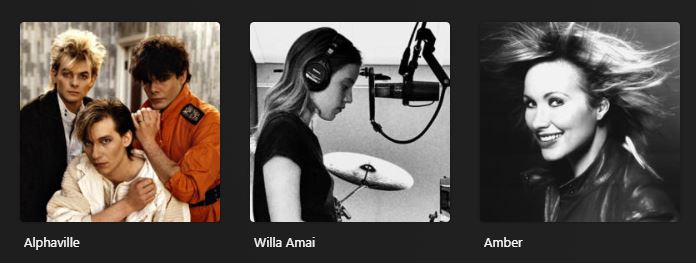

<If providing server logs please do NOT turn on verbose logging, only debug logging should be enabled>I want my artists to be sorted by what the artist name is in my music files, which is last name, first name. Thus, I turned on the “Prefer local metadata” option. However, what I’ve got is a mishmash. Some entries seem to use it and others don’t. I’ll have five artists listed as first name, last name, then folders with last name, first name. Is there another checkbox that needs to be checked?

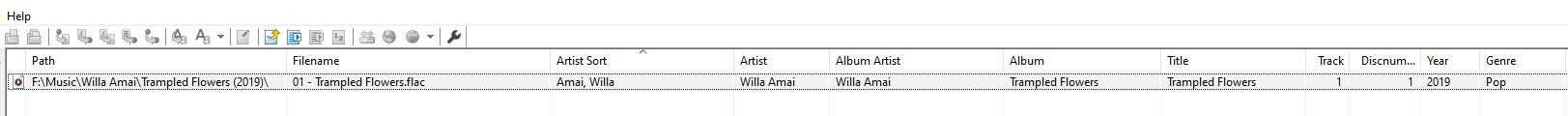

Note here (in Mp3tag) that Willa Amai has an Artist Sort of “Amai, Willa”.
Therefore Willa Amai is listed in the “A’s” within Plex.

The “Tag” I’m referring to is within the music file itself. The program Mp3tag will allow you to edit/view the metadata (tags) of your music files.
Plex looks at the “Artist Sort” tag to determine how to sort the artists within Plex apps.

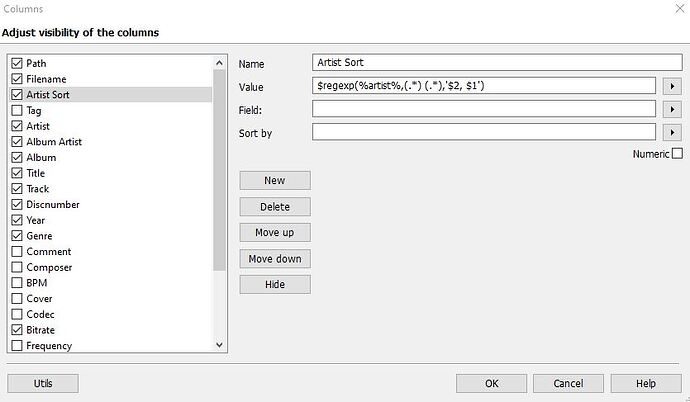

Click on View > Customize Columns > New.
Name it what you would like. Then put “$regexp(%artist%,(.) (.),‘$2, $1’)” in the value field. No I’m not smart enough to know what that means. I stole it from someone else. :slight_smile:
OK. Did that. And then?
If you checked the tick box to the left of what you added it (Artist Short) should show up then when you look at files in Mp3tag.
If not, I’m lost.
Well, the Artist Sort field appears as a column in the list of songs on the right (I wish I could attach an image!), but that is showing as last name, first name (which is what I want). So , that would appear to be correct, but it’s still not showing correct on the device that’s displaying this.
