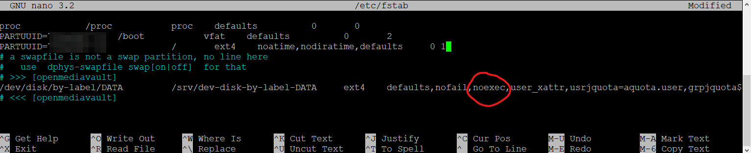

For anyone reading this with same problem here’s how I implemented suggestions above:
Solution 1: remove noexec from current mountpoint
  • SSH into Raspberry Pi
  • Open fstab (sudo nano /etc/fstab)
  • Under mountpoint(s) delete noexec:
  • Save & exit
That sorted problem for me. However, not 100% but from reading forum posts it seems that, even if you do this, OMV likes to re-mount with noexec after updates etc. and the problem comes back. I think solution is config file stops it doing that:
