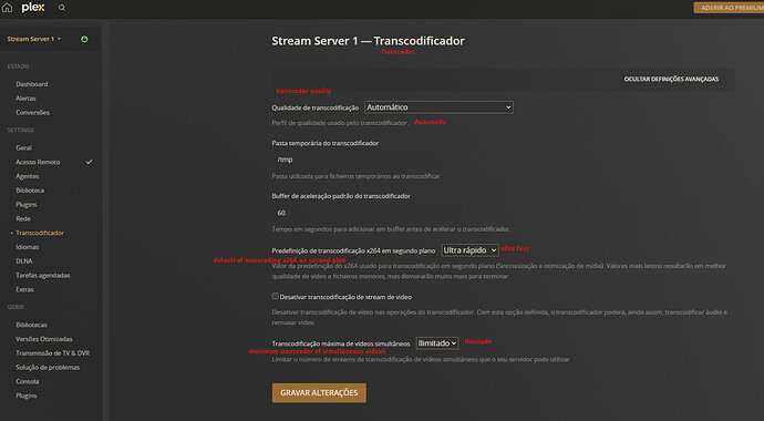

My transcoder settings:

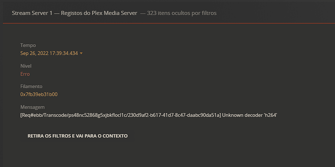

On logs I have those errors when I try to open any video:

This seems to be happening because it can’t load the necessary libraries for transcoding, such as
Sep 25, 2022 22:43:47.679 [0x7fb3a48ff1c0] WARN - [FFMPEG] - Error loading external lib: Error loading shared library /config/Library/Application Support/Plex Media Server/Codecs/c4efa15-4365-linux-x86_64/libaac_lc_decoder.so: Operation not permitted
Sep 25, 2022 22:43:47.680 [0x7fb3a48ff1c0] WARN - [FFMPEG] - Error loading external lib: Error loading shared library /config/Library/Application Support/Plex Media Server/Codecs/c4efa15-4365-linux-x86_64/liblibx264_encoder.so: Operation not permitted
Sep 25, 2022 22:43:47.680 [0x7fb3a48ff1c0] WARN - [FFMPEG] - Error loading external lib: Error loading shared library /config/Library/Application Support/Plex Media Server/Codecs/c4efa15-4365-linux-x86_64/libh264_decoder.so: Operation not permitted
Sep 25, 2022 22:43:47.680 [0x7fb3a48ff1c0] WARN - [FFMPEG] - Error loading external lib: Error loading shared library /config/Library/Application Support/Plex Media Server/Codecs/c4efa15-4365-linux-x86_64/libaac_encoder.so: Operation not permitted
Sep 25, 2022 22:43:47.681 [0x7fb3a48ff1c0] WARN - [FFMPEG] - Error loading external lib: Error loading shared library /config/Library/Application Support/Plex Media Server/Codecs/c4efa15-4365-linux-x86_64/libhevc_decoder.so: Operation not permitted
in your logs. This is probably because the “host” location for that /config mount has the noexec option set on the underlying storage
