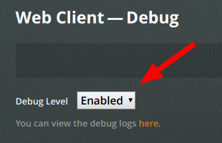

Did you actually stop and restart Plex server after that?`Because the log file you posted doesn’t contain a single ‘debug’ line.
Yes, I did. I shall attempt again…
Oh wait. You enabled logs for the web client, but not for the server.
The support document contains wrong screenshots.
Go to
Settings - Server - General
Oh you’re right, got it.
