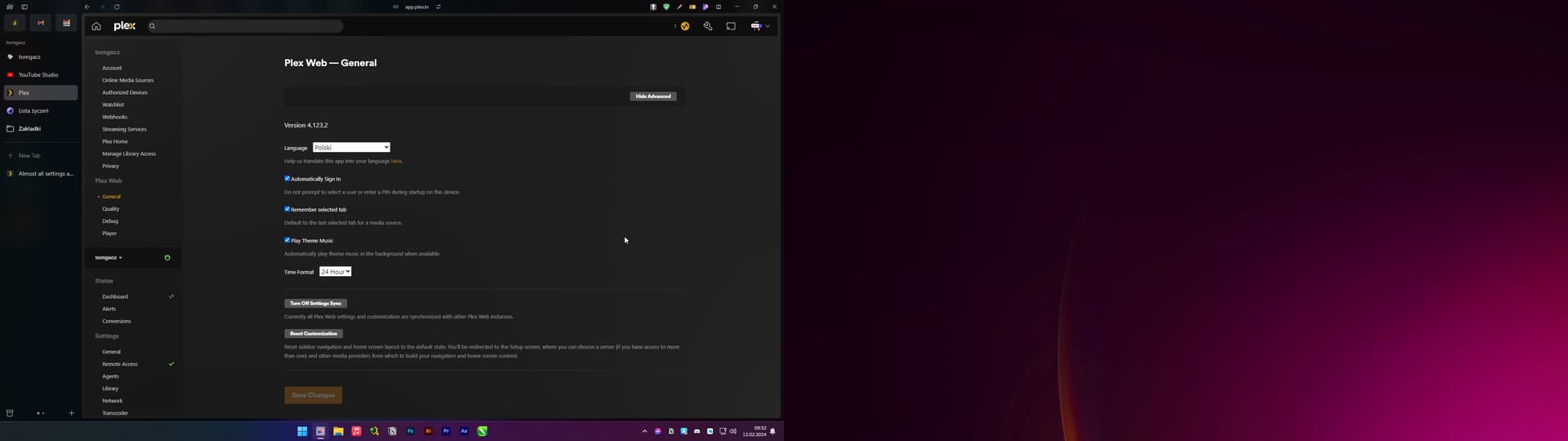

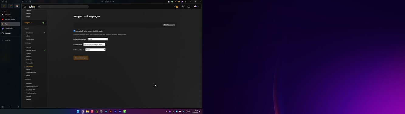

Almost all settings are in English languge, where Polish language is 100% supported
Almost all settings are in English languge, where Polish language is 100% supported and selected in settings.
Server Version#: 1.32.8.7639-fb6452ebf
Can you post a screenshot or two?
Sure, as i said, almost all settings are in english while i set polish :confused:

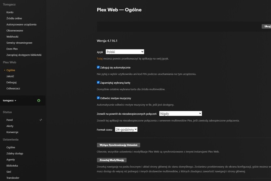

In your last screenshot above, could you inspect the language drop down a bit more closely?
Look if you see Polish more than once in the list. (the list might not be sorted like you’re expecting it)

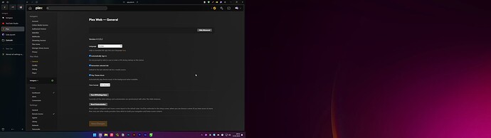

There is only once “Polski”. On chrome there is the same problem - I even check and I have Polish language set on Chrome and Windows 11. But when I open plex via ip adress (like right click and open plex on media server app) there is almost all in polish language. So it’s problem with plex web on app.plex.tv
This is how it’s look when i open on any browser via right click on plex media server:
