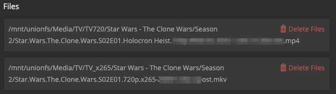

Heres a screen shot. The pic is displaying movies but it’s the exact same for episodes too.
Thanks for the reply. The files are there, they’ve been there for months, have not changed and Plex has them grouped but refuses to stop doing this on every scan. I just tried a full library scan again:

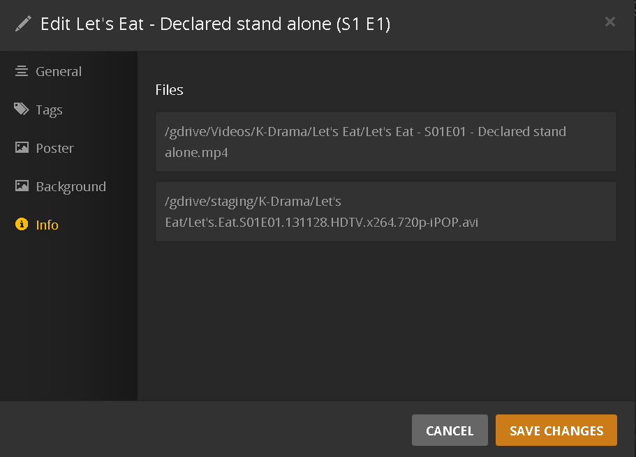

I’m getting the same behavior as well on 2 split media directories for the same film

After the first “didn’t exists” occurred, it happened again on the second directory
Sep 06, 2020 05:01:41.325 [0x7fd31788c340] DEBUG - File '/gdrive/staging/K-Drama/Let's Eat/Let's.Eat.S01E01.131128.HDTV.x264.720p-iPOP.avi' didn't exist, can't skip.

This happens every time I perform a library scan. And the library itself does show the 2 media files for every episode, however despite that it is still thinking the file did not exists on every scan.
