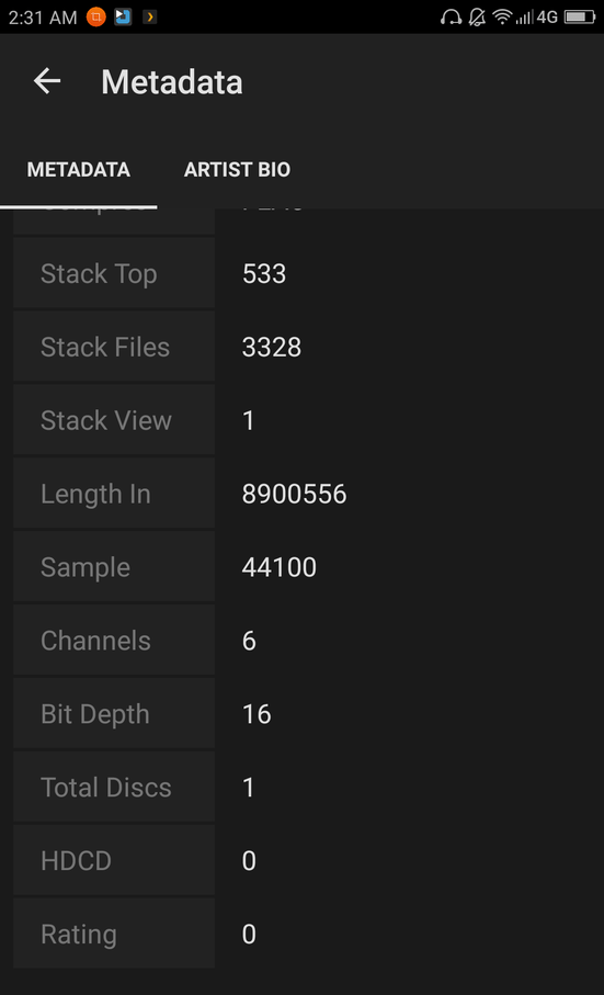

The actual issue I am facing is that when those multichannel flacs are played in the app, only 2 channels out of the 6 is heard due to the fact that it is not down-mixed to stereo and the phone has only 2 channels. Therefore I am hearing songs which are incomplete!!! This is the only issue!!!

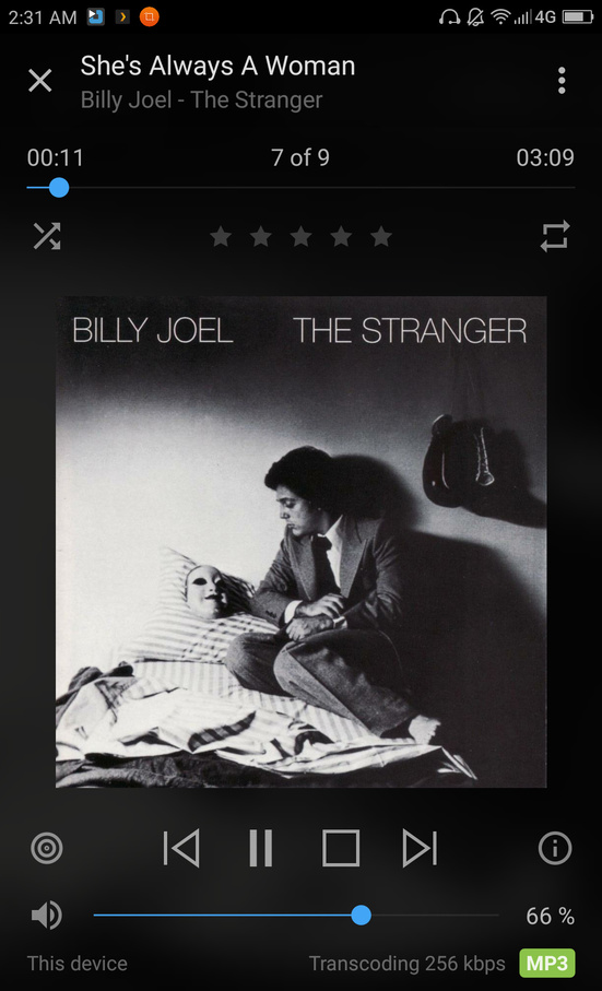

Are you sure you set the music quality? This what you should get.

I just realized, that setting is only for remote access. If you are on the local network it will still try to play as-is.

With Cellular 4g it is working remotely. Thanks!!! :+1:
Why cannot plex enforce transcoding flac files even in a local environment? When I listen 5.1 flacs in local on phones, then the audio is still incomplete unless trans-coded and down-mixed! If I use the phone as a client to plug it into an amp, still of no use unless remotely done!
