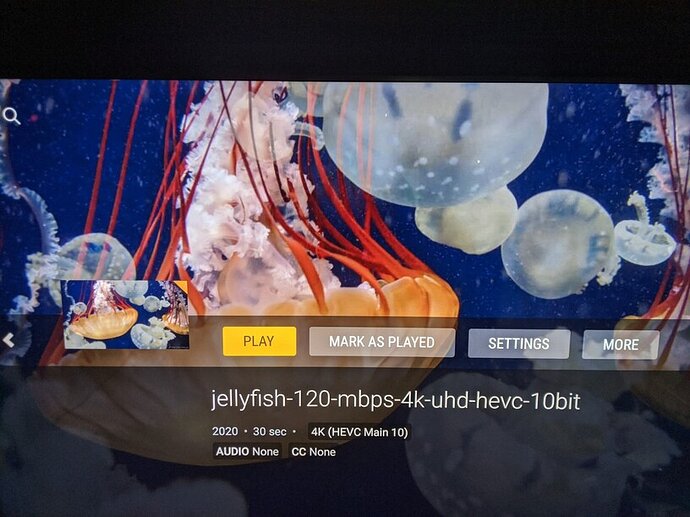

I use direct play to playback my 4k videos, which are h264, ≈60mbps bitrate and 8bit, 30 fps.

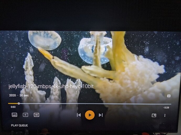

When I play them using displayMode ‘Original’ (not letterbox), only a quarter of the video is rendered.
After my analysis of the logs, seems to be a problem with how ExoPlayer picks up my TV’s screen size/resolution.

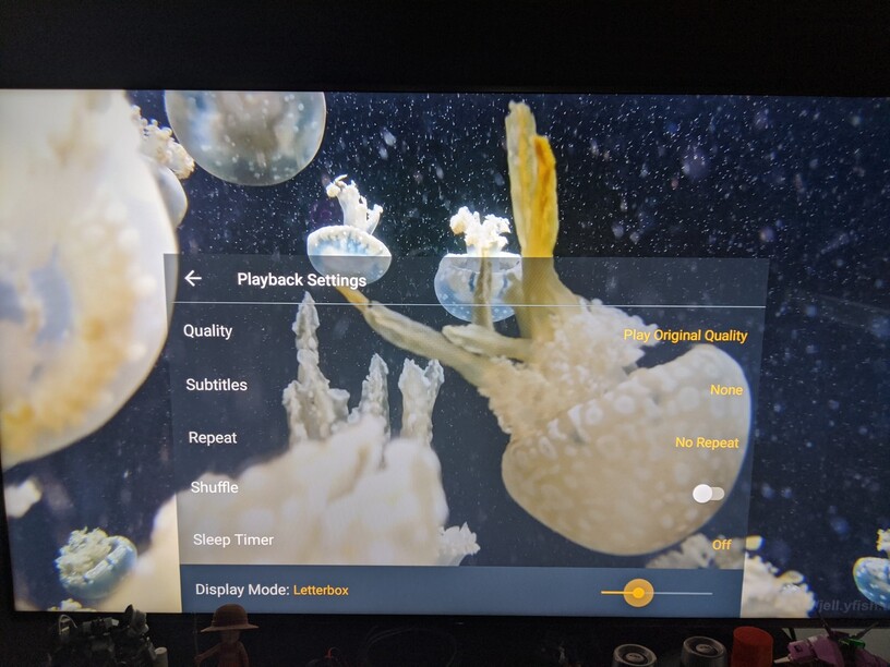

If i change the ‘display mode’ playback setting to ‘Letterbox’, the app now downscales my 4k video to 1080p, but that introduces buffering and also i really want to playback @ 4k and not 1080p.
