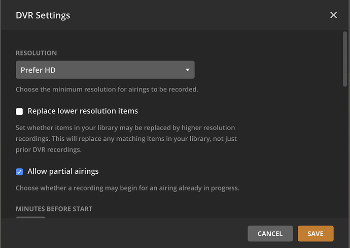

Have you got your tuner set to HD in DVR setup
Maybe. I did record something yesterday. But it kept going in and out and less than 5 minutes into it said I could not view the show. How do I see if my tuner is set to HD in the DVR setup?
Thanks for your reply also.
Ok, manage Live TV and DVR. Then DVR settings
I remember that screen. It does say “prefer HD”
