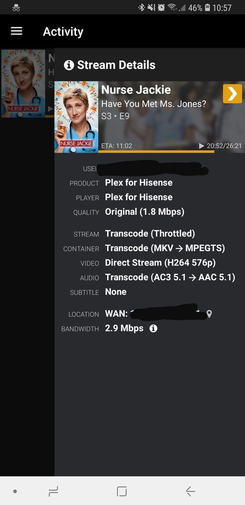

Recently (the last 2 weeks or so) any time audio needs to be transcoded on my nvidia shield, it also forces the video to transcode to.
This is not typical behaviour, normally if the audio needs transcoding it will simply direct stream the video, as expected.
Definitely isn’t a bandwidth issue, as it’s hardwired gigabit and can stream high bitrate 4k just fine.
No subtitles are being used (I’m well aware that subs + transcoded audio = transcoded video)
The same files playback absolutely fine on my chromecast and phone
Edit
BTW, the reason given for transcoding is “eac3 audio is not supported”. Nothing about video.
See the below screenshots to support the issue.

It’s set to 5.2, same as it has been for the 18 months or so that I’ve owned my shield. The whole time up until 2 weeks ago it worked completely normal, and would just transcode the audio. Nothing else has changed on my home setup recently except for replacing some network gear, but everything was working fine still after that.
It also seems unique to the shield, as here is an external user who has the audio being transcoded, but the video is being direct streamed, as it should be

Yeah, that is the expected behavior. Can you recreate the issue and provide logs from both PMS and the Shield? Also provide the xml for the video you tested with.
Latest update (7.29.0.15876) seems to have fixed it, all working as expected again
