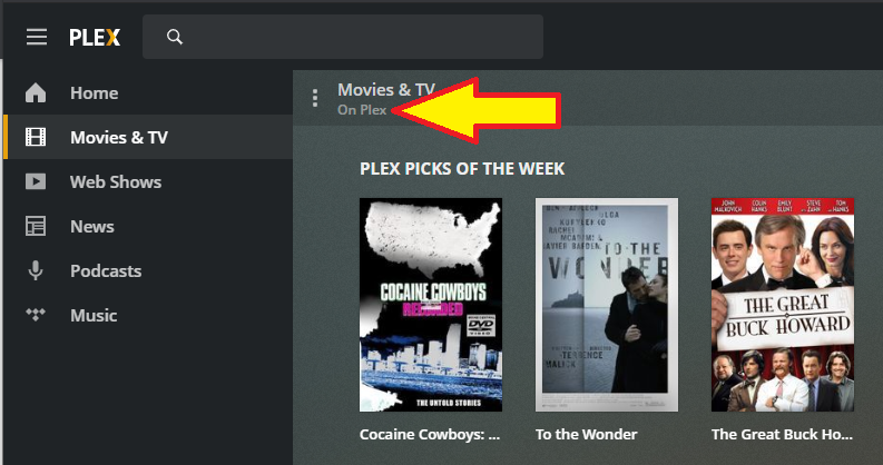

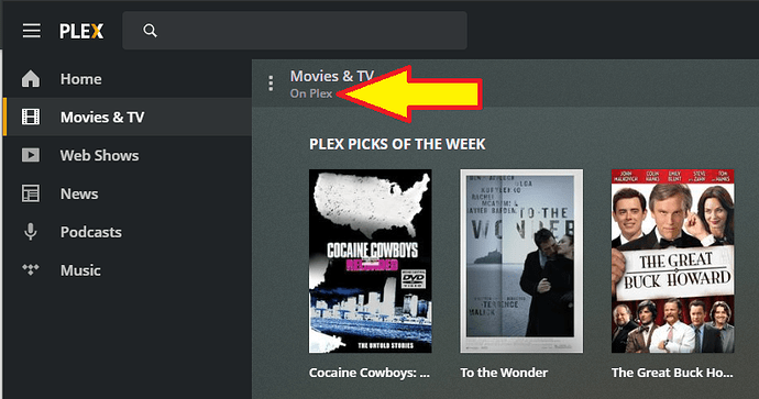

Do the Movies & TV appear from “On Plex”? See screenshot below for example.
If so, as @tom80H mentions, that is the part of the ad-supported on-demand service from Plex.
Anybody with an account at plex.tv has access. It does not require a server. The traffic flows from Plex servers directly to the client.
The screenshot below is from an account I use for testing. The account is not a Plex Pass account. It “owns” no Plex Media Server. No libraries are shared with it from any Plex Media Server. It still has access to the on-demand services.
