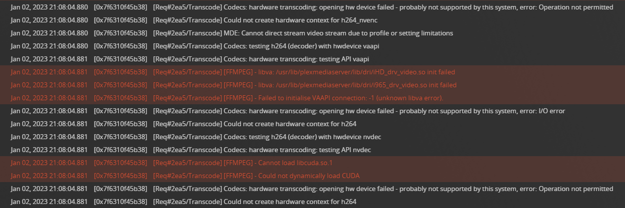

can you please recreate for me DEBUG logs which capture the failure of the A380 ?
The key error is being unable to init iHD_drv_video, caused by an outdated intel-media-driver
Another cause of this error is an outdated libva (a requirement of intel-media-driver)
Transcoding works fine if I enable my iGPU, but fails with just the Arc A750. Works fine with other software, just not Plex

Full log from when I hit play on a video, till I close the video (it does software encoding after giving up on hardware encoding): Removed
Kernel: Linux server-1 6.2.0-rc2+ #4 SMP PREEMPT_DYNAMIC Mon Jan 2 17:37:28 GMT 2023 x86_64 x86_64 x86_64 GNU/Linux
HuC and GuC are enabled, no errors with i915 in dmesg.
I’ve also tried this on Intel’s drm-tip based on 6.2.0-rc1 and it didn’t work.
