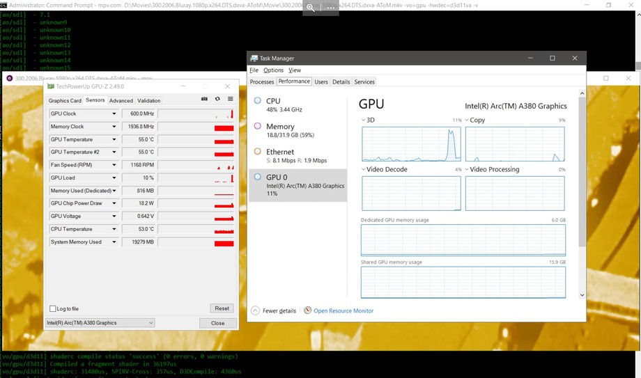

:man_facepalming: So it seems it is working. Test ran with iGPU disabled:
x264
[vd]     h264 - H.264 / AVC / MPEG-4 AVC / MPEG-4 part 10
[vd]     h264_qsv (h264) - H264 video (Intel Quick Sync Video acceleration)
[vd]     h264_cuvid (h264) - Nvidia CUVID H264 decoder

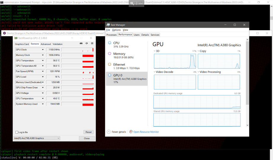

x265
[vd]     hevc - HEVC (High Efficiency Video Coding)
[vd]     hevc_qsv (hevc) - HEVC video (Intel Quick Sync Video acceleration)
[vd]     hevc_cuvid (hevc) - Nvidia CUVID HEVC decoder
Plex not using the A380
Could this because of the version of FFmpeg Plex uses?

So hw decoding is working with the A380. Also for x265? I see no decoding activity in your task manager. Is x265 actually working? (Does it state hwdec: d3d11 when hitting i in mpv?)
It is
x265
[vd] Requesting pixfmt 'd3d11' from decoder.
[vd] Using hardware decoding (d3d11va).

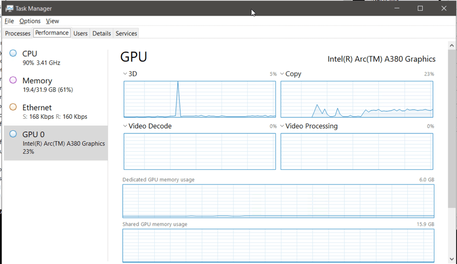

I played one x265 file then a x264 file. As before the x265 file shows hw transcoding but CPU is maxed out, the x264 file shows no hw transcoding, cpu maxed out again.

[h264_qsv @ 0000024530472340] some encoding parameters are not supported by the QSV runtime. Please double check the input parameters.
Error initializing output stream 0:0 -- Error while opening encoder for output stream #0:0 - maybe incorrect parameters such as bit_rate, rate, width or height
Conversion failed!
d3d11va
[h264_qsv @ 00000200b339ebc0] Current pixel format is unsupported
[h264_qsv @ 00000200b339ebc0] some encoding parameters are not supported by the QSV runtime. Please double check the input parameters.
Conversion failed!
qsv
[h264_qsv @ 0000017fa8dae340] Current pixel format is unsupported
[h264_qsv @ 0000017fa8dae340] some encoding parameters are not supported by the QSV runtime. Please double check the input parameters.
Conversion failed!
I cant get the x265 file to run. Seems like I need to add parameters in the command?
Updated PLEX logs
Plex Media Server Logs_2022-09-22_10-52-48.zip (433.7 KB)
Well, so we can draw the conclusion that dxva2 is not working on ARC (yet) and therefore not working with plex on the decoding side on windows. (Would interesting to see how it behaves on Linux) This is nothing plex can resolve, hopefully, Intel will fix it soon.
At least d3d11va and the direct qsv device works.
