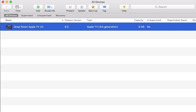

Cant seem to get the same screens as you have on your post. the only this i get when plugging in my ATV is the below!
what am i doing wrong?
Install cert via aTV2/3 over the air (using your network) apple configurator is obsolete:
Press play when send data to apple is set to NO using your remote.
Pressing play didn’t work for me. Had to use Apple Configurator + USB cable.
