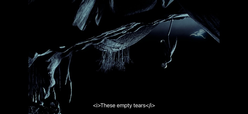

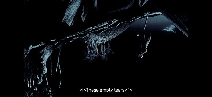

SRT external subs still show /i/ SUBTITLE HERE /i/ during the singing parts of the movie instead of italicizing the font. Happens on both iOS and Apple TV platforms.

SRT subtitles on iOS also show the < i > SUBTITLE </ i> as shows on my Apple TV. But sizing and placement is perfect.
