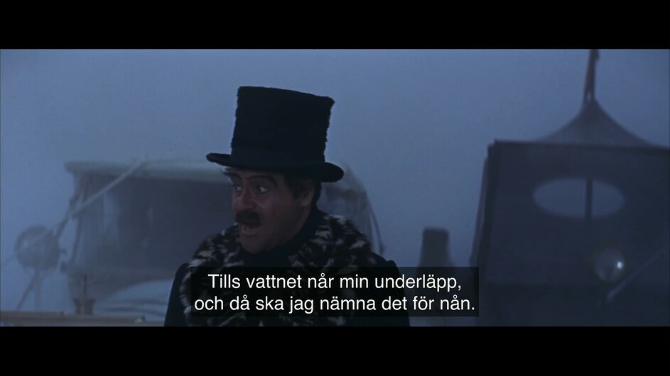

Not only eastern European characters. It seems that decoding of UTF-8-characters doesn’t work. Also, subtitles which are supposed to go on two lines are only displayed on one.
Beta version 8.46 (9706):
Release version 8.45 (9684):
