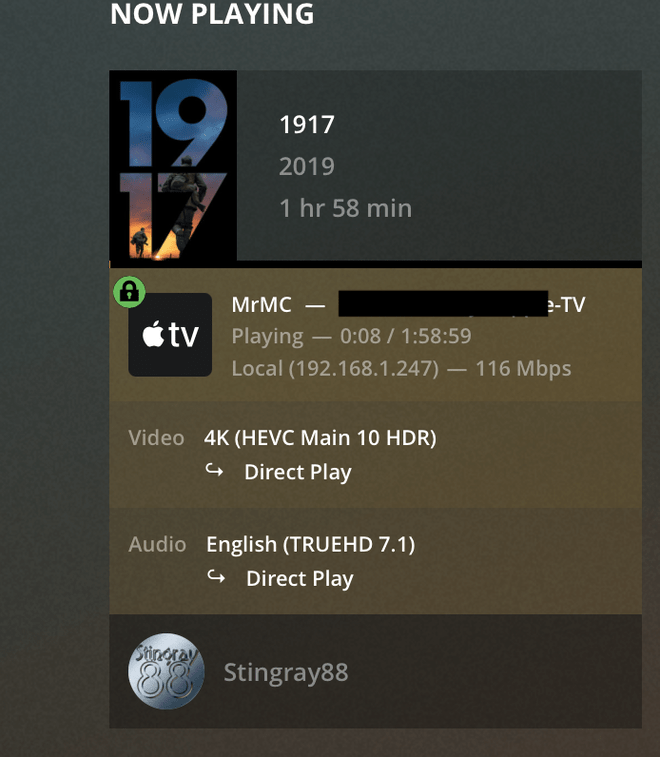

He’s asked why can’t PMS send the unaltered file directly to the Plex app (Direct Play) so that the AppleTV is the one transcoding the audio from TrueHD/Atmos over to PCM, instead of PMS.
Both Infuse and MrMC (Kodi) are fully able to do this. I’ve tested it myself on my AppleTV 4K, where I’ll test the exact same file coming from the exact same PMS, and right in the dashboard it says Direct Play for video/audio when playing in Infuse or MrMC… and yet when you load it up in the Plex app, it will Direct Stream the video and transcode the audio.
Yes, its true TrueHD/Atmos can’t be passed through on the AppleTV 4K currently… but no, that doesn’t mean PMS must transcode the audio, the AppleTV can do it itself. So this is indeed a limitation of Plex, as in the app on the AppleTV, considering Infuse/MrMC clearly don’t have this issue. This doesn’t solve the OPs root problem in the end, but it does indeed show a limitation of the Plex app.
See for yourself on the attached images -
