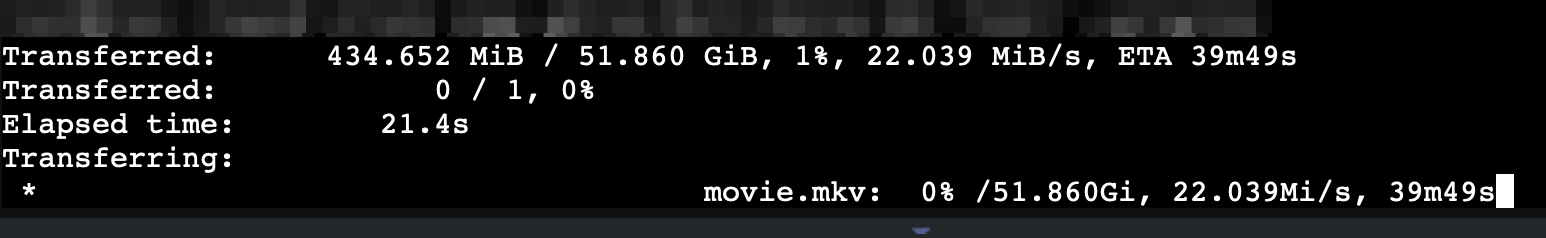

Please see attached screenshot. I tried to copy the movie from Google Drive to locally, and this is the stats I got.
Well… that’s not fast enough to stream the file as-is in real-time.
Would it solve the issue to pause the movie and let it buffer for a few minutes or what do you think would solve this issue while still keeping the movie in Google drive
No, Plex will only buffer a limited amount of time – not the entire movie.
