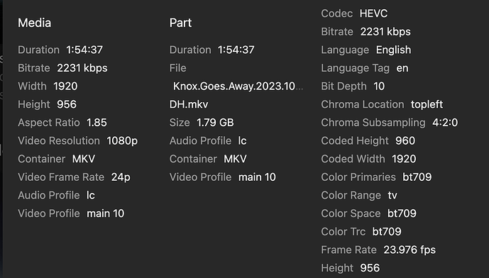

Here’s the info on the mkv file:
Here’s the important details:

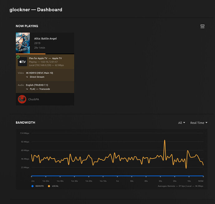

I will need to unpack and test with my appletv but my thoughts are:
  1. Which AppleTV ? (some models are not as good)
  2. Network throughput
HEVC main10 is a strange decision for 1080p.
If it’s a very old AppleTV, the HD models, might not can do main10.
AppleTV 4K (2017)
This AppleTV 4K is connected via WiFi

  1. HEVC
  2. BT709 ??? (that’s not standard for HEVC)
  3. 2.2 Mbps? That’s something re-encoded.
Not sure who/what did that video but I challenge its validity
