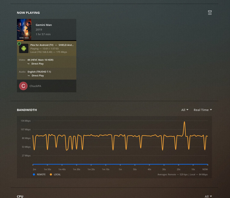

I’m doing some reloading here, from scratch, to see if anything has changed for me.
Where I’m having trouble:
- Both are wired.
- Both are high-end AVRs
I can hit it with 80+ Mbps without issue.
Give me a few please… Head-scratching time
I’m going to push through both the ATV 4K and Shield Pro 2019 – again
I get no skipping or anything here.
This is a good stress test of any Audio Video system.
59.94 Hz, 2160p, HEVC
