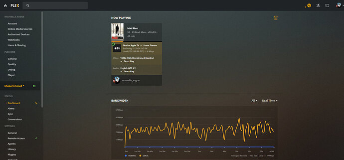

FWIW, I too am now having an issue with ATV. Latest non-4K.
For no reason whatsoever, itās transcoding down to 720. Itās a flat network. All the settings on the server side are as they should be. Same with the ATV which has not changed since itās installation. Plex settings too are fine. Iām being lazy here and just posting the debug screenshot. I will get logs later.
Also, in the playback settings as shown, it will default to what you see selected and I cannot select anything else. No idea what happened here.
Can I be lazy and ask how low the source bitrate is? Whatās the converted to rate?
(it looks like a crap 1.4 Mbps video stream)
Iām willing to bet that converting to 720p is the problem (720p does have a low default)
These are straight blu ray rips. Agree the problem results in a junk image. It is set for direct play so no idea why itās happening all of a sudden. Iām not trying to convert.
So I have no idea what happened, but I rebooted the PMS VM and everything went back to normal. It turns out I was having other non-PMS related issues with that VM so itās probable that whatever it was had affected this as well. Just odd that it half worked.

To provide a comparison, here is my AppleTV 4k after running for 13 continuous hours (and still playing as I write this). Iām watching for a memory leak.
There are no quality issues. I am using the enhanced player (Plex Pass).
Please note how smoothly my network behaves.
Also note that , even after 13 hours of non-stop playback, now part way into the 11th item, with only 80 dropped frames. This is normal behavior to have a possible dropped frame or two (less than 1/12 of a second) at the beginning and end of a movie during resolution switching.
