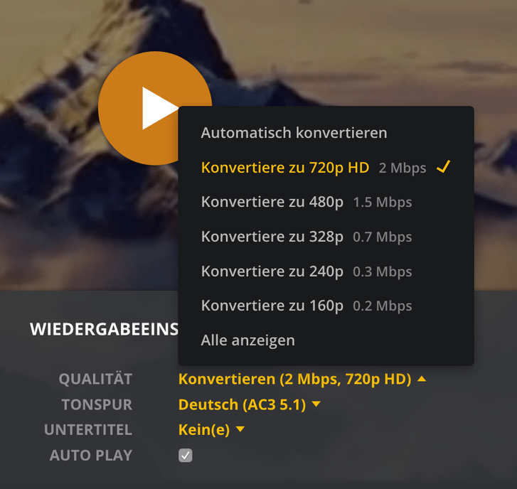

I think i never had this issue until you introducued this feature :slight_smile:
Plus i think it only happens on Plex/Web
In the exact same moment i can play 4K on Shield O_o
Thank you for the logs.
Looking at the transcoder invocation line, I see where the video bitrate is being limited.
Aug 03, 2019 15:34:07.778 [0x7f725ffff700] DEBUG - Job running: EAE_ROOT='/tmp/pms-113e42ce-32c1-4040-86b9-f259c6db2992/EasyAudioEncoder' FFMPEG_EXTERNAL_LIBS='/var/lib/plexmediaserver/Library/Application\ Support/Plex\ Media\ Server/Codecs/2144ff1-2376-linux-x86_64/' XDG_CACHE_HOME='/var/lib/plexmediaserver/Library/Application Support/Plex Media Server/Cache' XDG_DATA_HOME='/usr/lib/plexmediaserver/Resources' X_PLEX_TOKEN='xxxxxxxxxxxxxxxxxxxx' '/usr/lib/plexmediaserver/Plex Transcoder' '-codec:0' 'h264' '-codec:1' 'ac3' '-ss' '5384' '-analyzeduration' '20000000' '-probesize' '20000000' '-i' 'http://127.0.0.1:32400/library/parts/1307604/1508354886/file.mkv?X-Plex-Token=xxxxxxxxxxxxxxxxxxxx' '-filter_complex' '[0:0]scale=w=720:h=406[0];[0]format=pix_fmts=yuv420p|nv12[1]' '-filter_complex' '[0:1] aresample=async=1:ocl='\''stereo'\'':osr=48000[2]' '-map' '[1]' '-codec:0' 'libx264' '-crf:0' '21' '-maxrate:0' '1070k' '-bufsize:0' '2140k' '-r:0' '23.975999999999999' '-preset:0' 'veryfast' '-level:0' '5.1' '-x264opts:0' 'subme=6:me_range=4:rc_lookahead=10:me=hex:8x8dct=1' '-force_key_frames:0' 'expr:gte(t,5384+n_forced*8)' '-map' '[2]' '-metadata:s:1' 'language=ger' '-codec:1' 'aac' '-b:1' '162k' '-segment_format' 'mpegts' '-f' 'ssegment' '-individual_header_trailer' '0' '-segment_time' '8' '-segment_start_number' '673' '-segment_copyts' '1' '-segment_time_delta' '0.0625' '-segment_list' 'http://127.0.0.1:32400/video/:/transcode/session/7508e2a6d73c3e9c-com-plexapp-android/989e9080-9e4c-45b6-9fde-8bcdadf86cf5/seglist' '-segment_list_type' 'csv' '-segment_list_size' '2147483647' '-segment_list_separate_stream_times' '1' '-max_delay' '5000000' '-avoid_negative_ts' 'disabled' '-map_metadata' '-1' '-map_chapters' '-1' 'media-%05d.ts' '-start_at_zero' '-copyts' '-y' '-nostats' '-loglevel' 'quiet' '-loglevel_plex' 'error' '-progressurl' 'http://127.0.0.1:32400/video/:/transcode/session/7508e2a6d73c3e9c-com-plexapp-android/989e9080-9e4c-45b6-9fde-8bcdadf86cf5/progress'
resulting in: ‘-codec:0’ ‘libx264’ ‘-crf:0’ ‘21’ ‘-maxrate:0’ '1070k’
This matches with what you show in the screenshot.
