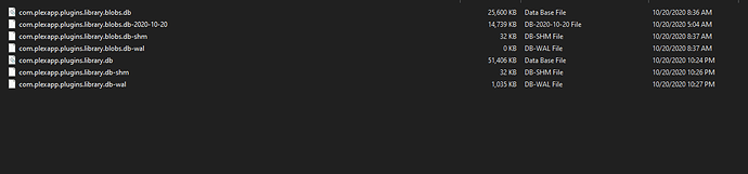

Right now this is what I see…
Settings - Server - Scheduled Tasks - ‘Show Advanced’
Is there anything in “Backup directory”?
And if so, is this a different path than the regular database folder?
Path / folder is the same as the path / folder of the screenshot
I lost track somehow. What is your screenshot showing? The database folder after you created a new data base, or before?
No worries. My expectation based on the link above is that there will be matching blobs and library files - two files with the same dates for a proper backup.
  1. Before I corrupted the db by making edits to it while Plex was running, I had blob files to current day. The other file not since August.
  2. After corruption and creating a new database, the screenshot is currently what I’m seeing. It’s the same two days later. Again no matching non blobs file with the same 10-20 date.
