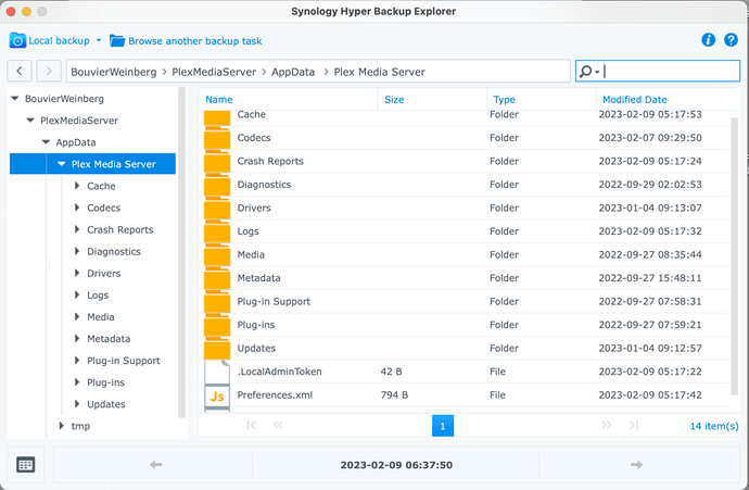

  1. HyperBackup will, with PMS stopped, make a perfect Compressed Image Backup of the entire PlexMediaServer shared folder.
  2. Should you need to restore from it, EVER customization you had will be restored, It’s a perfect snapshot of everything.
Thanks to you and @FordGuy61- backed all PMS folders to Synology using Hyper Backup.
