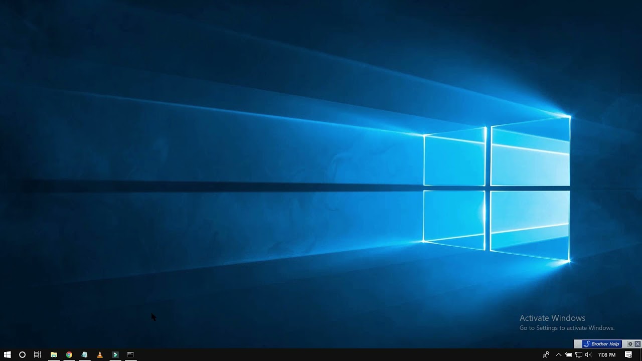

Here’s a faster way… took less than 5 minutes for 4,500 movies. Script is below the video.
@echo off
for %%i in (*) do (
if not “%%~ni” == “organize” (
md “%%~ni” && move “%%~i” “%%~ni”
