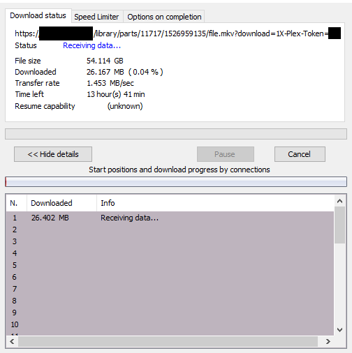

I have a server in Germany hosting my Plex content with a 1Gbps uplink. My connection at home is capable of 100Mbps down, however I live in Australia so there is quite a bit of latency (~300ms) between me and my server. I can stream up to 20Mbps, but anything above that needs to buffer every few seconds. This bothered me as my home connection is definitely able to handle more than that, and I would eventually like to stream UHD 4K.
I am by no means a networking expert but after doing some research I believe this is due to the extreme latency between me and my server. What I do know for certain is that multiple connections increase my download speeds significantly. In the screenshots below I am using Internet Download Manager (IDM) to download a movie from my library using a download link generated by Plex. You will see using 8 threads (~10MB/s) gives an almost linear increase in speed over 1 thread (~1.5MB/s). I also used iperf3 to test my connection which gave very similar results.

IDM using 1 thread (~1.5MB/s)
screenshot of IDM using 1 thread
