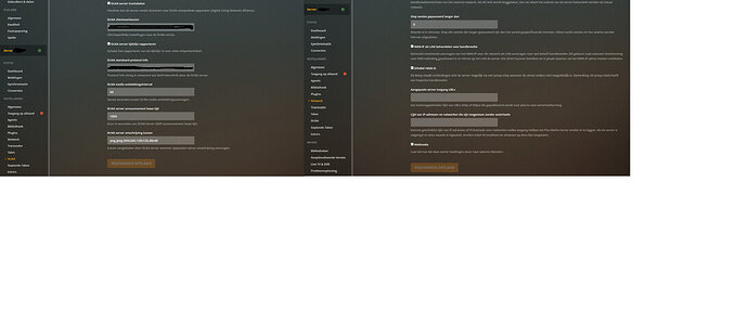

Thank you both for the asnwer. but like enclosed picture, nobody is listed as allowed without auth. and DLNA is turned off
and yes, they can see my server without the plex application. but i dont have te media server application running on my synology. And without this DLNA shouldnt work on synology.

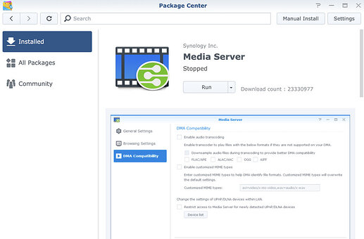

AFAIR Synology brings its own DLNA server by default i.e. it will work even if Plex server is not installed onto the NAS at all.
Shutdown Plex Media Server on the Synology.
Can the TV still see/play the media files?
Not entirely by default but pretty standard. It’s a package called “Media Center” and it controls the DLNA functions and is good guess for the situation:
@User_Unknown see if you have Media Server in your Application Panel (the menu in upper left). The Synology default for this is “broadcast it all” particularly if you ever setup Video Station (or DS Video); to be fair that’s the point of DLNA really. If you used the same media folders for Plex as for Video Station those folders will be DLNA navigable folders. Plex highly advises against using the Synology media folders with Plex.
