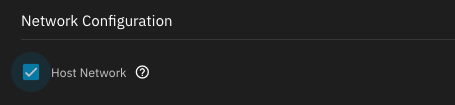

Just a thought, on the TrueNAS, did you set Plex to run in Host mode? If not, it’s running Bridge and creating its own isolated network which would trigger the remote watch pass prompt.
I considered that, but the above made me think they’re in host most.
Is that the same IP they see on the Remote Access page under PrivateIP, that would confirm.

I’ve run it in both bridge and host modes, and both will not trigger the remote watch pass prompt if I access the server by IP address, and will trigger the remote watch pass prompt if I access the server by FQDN.
