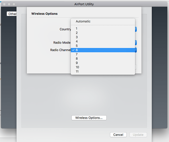

Gentlemens good news everything is working again as it should ( I cross my fingers). Indeed a network issue was causing this. Wiring the server to the router made the symptom disappear. I also tried another router config to keep it wireless and that did the trick as well (going from automatic to a fixed channel number in the config.
To all of those who have took a look at the issue I’d like to thank you very much.
