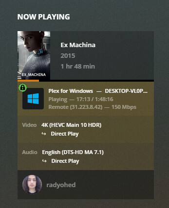

I’ve just tried to playback two movies. I’m adding the XML files and screenshots of the dashboard while I playback them. They are both direct playing.
The result is Leon buffered on both my PC and TV, while Ex Machina buffered only on TV.

Ekran görüntüsü 2020-12-28 004952 Ekran görüntüsü 2020-12-28 010835 Ekran görüntüsü 2020-12-28 011019 Ekran görüntüsü 2020-12-28 011107
You’ll buffer when streaming a 70 Mbps movie on a 75 Mbps connection.
