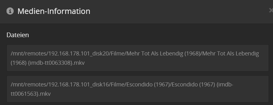

Even with the correct IMDB-ID in the filename, Plex matches both movies into one (tt0063308). This is wrong. These are two different movies:
Escondido (1967) {imdb-tt0061563}.mkv
Mehr Tot Als Lebendig (1968) {imdb-tt0063308}.mkv
Thanks for listening.
They show up as two different movies on our end.
How exactly are the files organised in their parent folders and are they not accidentally the exact same file?
Thanks for your answer. They are completely different. Please see below. TowerVM01 is a VM with remote SMB Shares on Unraid.:

The result in Plex - both applied to the first one:
Just an idea: If you look at IMDB. Both share the same localized name “Escondido”. But that would mean that Plex ignores the IMDB-ID in the filename here.
