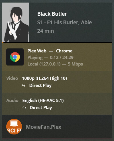

You can already play h264 10-bit without needing to modify the profile. Keep in mind Chrome only supports this for mp4. If your file is mkv, that wont’ work.

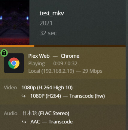

That doesn’t do it for me. I even have completly removed my profile and it still won’t play without transcode
Don’t forget to restart PMS after making profile changes.
(Profiles are loaded into memory when PMS starts)
I did restart and i see that my profile is not used anymore because else it would stream flac instead of transcoding that to aac.
I can provide logs of that session if that helps?
In which log file did you find that so i can look at that myself?

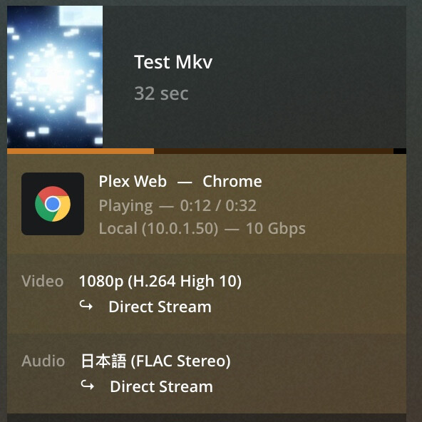

I added FLAC, and get that Direct too now. I didn’t try with your .xml.

<?xml version="1.0" encoding="utf-8"?>
<Client name="Chrome">
  <!-- Author: Plex Inc. -->
  <TranscodeTargets>
    <VideoProfile protocol="hls" container="mpegts" codec="h264" audioCodec="aac,mp3" context="streaming" />
    <VideoProfile protocol="dash" container="mp4" codec="h264" audioCodec="aac,flac" context="streaming">
      <Setting name="ForceTranscodesForLive" value="true" />
      <Setting name="SkipAudioBeforeStart" value="true" />
      <!-- <Setting name="BreakNonKeyframes" value="true" />  -->
    </VideoProfile>
    <VideoProfile protocol="http" container="mkv" codec="h264" audioCodec="aac,mp3" context="streaming" />
    <MusicProfile container="mp3" codec="mp3" />
    <PhotoProfile container="jpeg" />
    <SubtitleProfile container="ass" codec="ass" context="all" />
  </TranscodeTargets>
  <CodecProfiles>
    <VideoAudioCodec name="*">
      <Limitations>
        <UpperBound name="audio.channels" value="6" />
      </Limitations>
    </VideoAudioCodec>
  </CodecProfiles>
  <!-- When transcoding a multi-channel audio stream inside a video transcode, downmix the audio stream to stereo. -->
  <TranscodeTargetProfiles>
    <VideoTranscodeTarget protocol="*" context="streaming">
        <Limitations>
          <UpperBound name="audio.channels" value="2" onlyTranscodes="true" />
        </Limitations>
      </VideoAudioCodec>
    </VideoTranscodeTarget>
  </TranscodeTargetProfiles>
</Client>
Thank you Volts
I copied your config and it does work, it seems like I have something in the config file that I provided which doesn’t get parsed right because with that it doesn’t work.
Nice!
Small moves, Ellie. Small moves.
