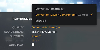

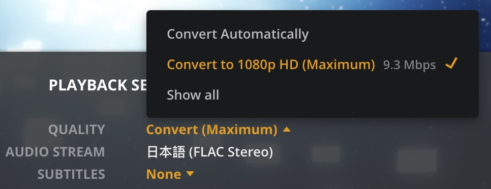

In the Web player, 10-bit video shows as Convert to ...

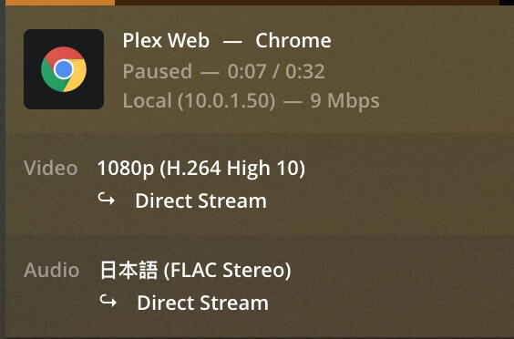

But in the dashboard:
I’m not suggesting it’s wrong or that I’m worried about it. I just think it’s interesting, and perhaps indicates that the Profile change didn’t magically make Plex Web correctly aware of 10-bit streams.
