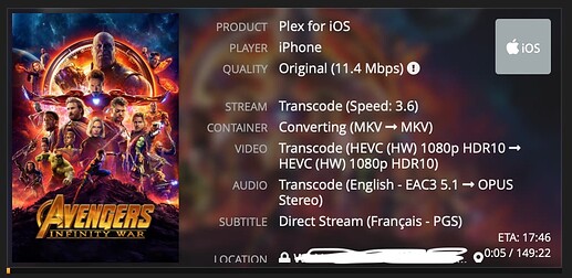

I discovered a bug in Plex iOS that’s extremely disturbing.
Situation
I have a movie in 2 versions:
  • 4K 60 Mbps HDR10 with TrueHD 7.1 Audios and PGS Subtitles
  • 1080p 4Mbps HDR10 with EAC3 5.1 Audios and PGS Subtitles
    My PMS max bandwidth for WAN is set to 12Mbps.
    iOS Player is set to Maximum for LAN ; 10 Mbps for WAN (but setting the maximum bandwidth doesn’t help).

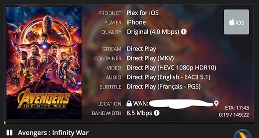

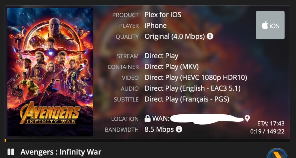

v → When trying to stream from LAN, the 4K is direct played successfully with the player as intended.
v → When trying to stream from LAN/WAN the 1080p version manually, the 1080p version is direct played successfully, as intended.
x → But when trying to stream from WAN, the 1080p version is transcoded towards the maximum bitrate specified in the iOS Player.
The logs (attached) says that Direct Play is disabled while it’s not.
I would expect that when on WAN, the 1080p version is direct played because enough bandwidth is available and all codecs (video, audio, sub) are compatible with the mpv player. Something must be broken in the decision making from PMS and/or the player.

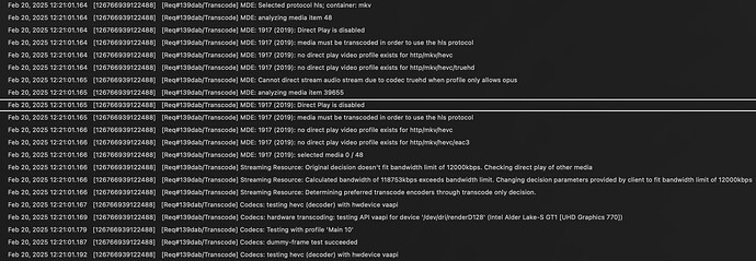

The messages in the logs are quite clear :
Using the Resume button on movie A
[Req#b08c1/Transcode] Streaming Resource: Original decision doesn't fit bandwidth limit of 40000kbps. Checking direct play of other media
[Req#b08c1/Transcode] Streaming Resource: Calculated bandwidth of **118753kbps** exceeds bandwidth limit. Changing decision parameters provided by client to fit bandwidth limit of **40000kbps**
[Req#b08c1/Transcode] Streaming Resource: Determining preferred transcode encoders through transcode only decision.
[Req#b08c1/Transcode] Streaming Resource: Reducing playback quality for **38095kbps** stream bitrate: audio channels to 2, quality to 54, disable video DS as **2147483647kbps** is > the **37701kbps** available
[Req#b08c1/Transcode] Streaming Resource: Reached Decision id=29600 codes=(General=2000,Neither direct play nor conversion is available. Direct Play=3000,App cannot direct play this item. No direct play video profile exists for protocol http, with container mkv, and video codec hevc. Transcode=4002,Not enough CPU for conversion of this item.)

[Req#c2a82/Transcode] Streaming Resource: Original decision doesn't fit bandwidth limit of 40000kbps. Checking direct play of other media
[Req#c2a82/Transcode] Streaming Resource: Calculated bandwidth of **115865kbps** exceeds bandwidth limit. Changing decision parameters provided by client to fit bandwidth limit of **40000kbps**
[Req#c2a82/Transcode] Streaming Resource: Reducing playback quality for **38095kbps** stream bitrate: audio channels to 2, quality to 54, disable video DS as **2147483647kbps** is > the **37701kbps** available
[Req#c2a82/Transcode] Streaming Resource: Reached Decision id=256 codes=(General=2000,Neither direct play nor conversion is available. Direct Play=3000,App cannot direct play this item. No direct play video profile exists for protocol http, with container mkv, and video codec hevc. Transcode=4002,Not enough CPU for conversion of this item.)
From my understanding, the logic behind the version selection when trying DirectPlay seems broken as it seems to use the calculated bandwidth of the original 4K version (which are above 100Mbps) instead of the one from the 1080p version (which is 9612kbps) to take his decision to directly the lower resolution version.
