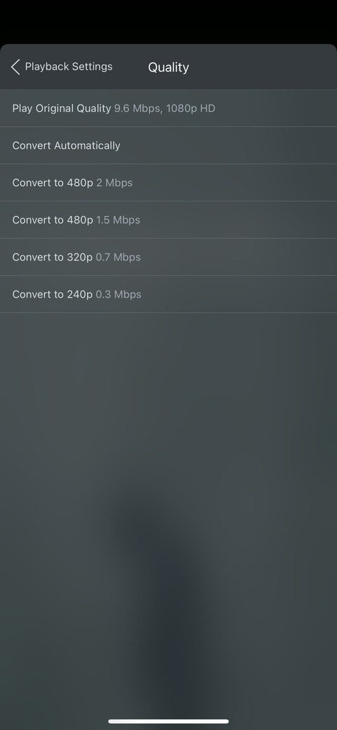

For some reason, I can’t select any options above 480p when choosing to transcode:
It’s either original quality or 480p or lower.

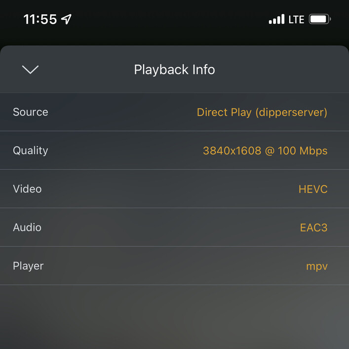

Here is what happens if I play with “Original Quality” enabled. It shows that I’m directly connected to the server via Tailscale and correctly shows the “Direct Play” status. However, the quality options still max out at convert to 480p, below the original quality and convert automatically options.
I’m not sure how the quality dropdown “guesses” (incorrectly) about the indirect playback, but I think it should be better if it can query the direct play status from the playback info page and allow me to use all quality options available.

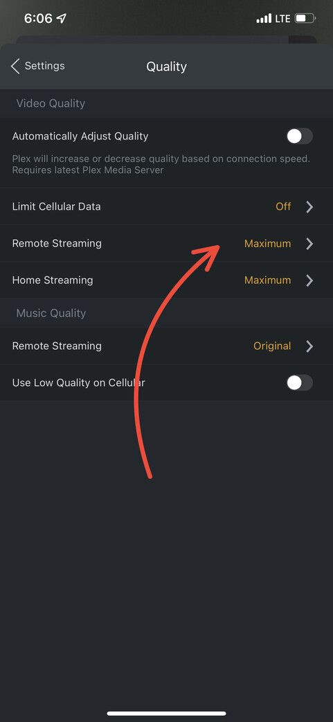

I’ve found a weird workaround to this problem and potentially the cause of the bug.
If I go into the quality settings and set “Remote Streaming” to maximum:

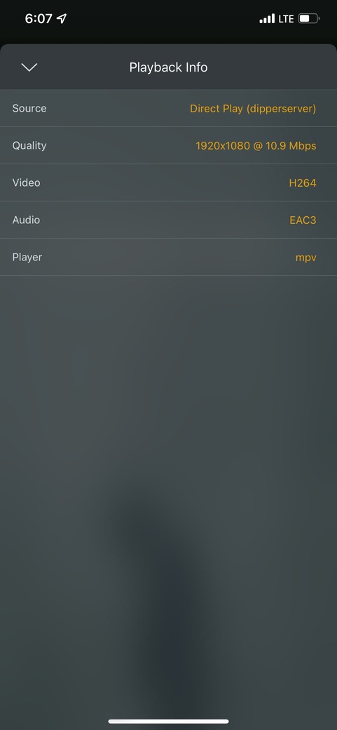

Then the “Play Original Quality” option will be selected, and the playback info window will show I’m directly playing:

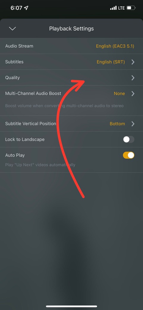

Now if I go back to the quality settings and set the option to 720p high:
Now the Plex quality selector will be blank, and going inside the menu, we can see none of the options are selected!
However, Plex is correctly transcoding down to 720p 4 Mbps as shown in the playback info window!
This indicates to me that this isn’t some sort of problem with the server or network connection type or anything like that (which I’ve already disproven by port forwarding, and that didn’t work) but rather a visual glitch in the iOS client app that does not display all the convert options in the list. I think this is a rather simple visual bug. @anon18523487 can this be submitted as a bug report?
