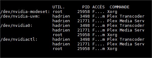

When a stream is transcoding, we’ve got this :
STREAM
and processes :
fuser
But when the stream is stopped, or canceled :slight_smile:
after
The PID 21771 is still alive, it’s a relicate of the streaming, et it keep my GPU on work ! (P0 state).
Must kill this process at the transcode killing signal … because it keep active the transcoding work

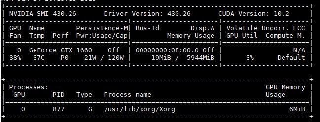

AFTER-SMI
You can see the P0 state, 21w and 0 transcoding process, if i kill the 21771 :
AFTER-SMI-KILL
EDIT : I found the bug !
There are 2 process pid, “Plex Media Serv” (PID 001) and his child “Plex Transcoder” (PID 002).
Stop or cancelled streaming kill the child, but not the parent !
You must kill the parent ( which will stop the child process ), or just assign PDI 002 to nvidia

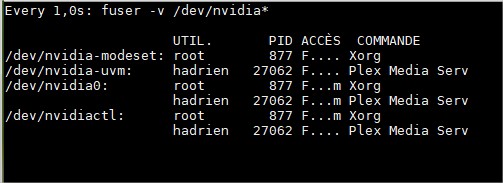

FUSE-WITHOUT
And after kill the stream

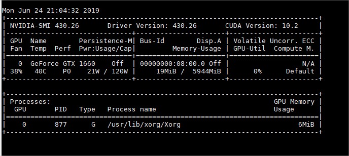

WITHOUT-AFTER SMI-WITHOUT
Note the 19mo (but only 6 for Xorg, 13 mo for “hidden” process “Plex media serv”)
It seems that Plex attributes a process (parent of transcoding in fact) that is not transcoding to the GPU
