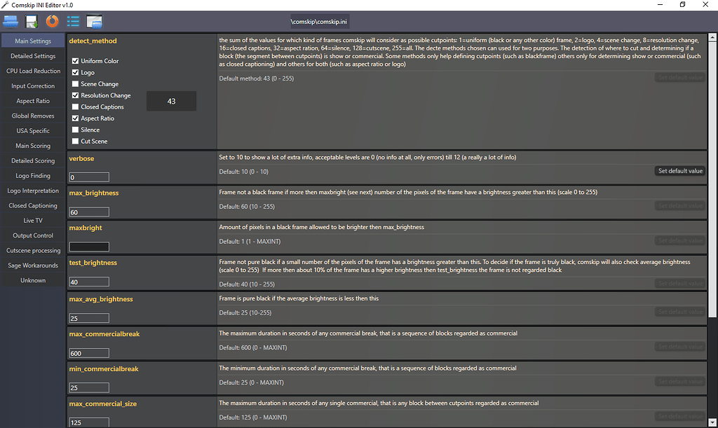

for years I to have been using MCEbuddy and comskip to remove commercials. I have thrown that all out completely and am now letting Plex handle things since they added the “Detect Commercials and mark for skip” to the DVR setup. I never liked altering the files because mistakes can be made in the process and cutting the start of the show is so frustrating.
I also tuned the comskip.ini things are working really well
just put the file Plex Media Server\DVR
comskip.zip (2.6 KB)
